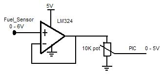

    I'm trying to measure my car fuel level and something is wrong. The fuel sensor scale is 0 - 6V and, of course, I would like to read from 0 - 5V. The image attached shows the schem I've down till now.
    The thing is that the sensor value is 4.95V (now) and 4.12V is expected in PIC. It is getting 3.6V.
    I suppose that there can be 2 mistakes:
    1) LM324 VCC must be more than 6V.
    2) There is a voltage divider between POT and LM324 output impedance causing voltage in POT be less than fuel sensor signal.
    Hope you can help..
    Thanks in advance AGAIN!
    Sylvio

    I think you are on the worng track. I'm using ADC to measure the fuel level but the sensor range is from 0 to 6V. It is necessary to scale down from 0 to 5V so that PIC can 'read' it. My problem is on the lm324 (opamp as a buffer).
    Thanks.

    I totally agree with you. But maybe I forgot to explain something that, unfortunatelly, I am not sure. My car fuel sensor is a voltage divider, I think. The sensor is a variable resistor and its range is from 40 to 280 ohms and it turns that the voltage range, as I said, is from 0 (1,66V) to 6V. If I use a simple voltage divider in this fuel signal, will not it change the signal that is being send to the car? That is the reason why I am using the opamp as a buffer..
    Thanks again..
    The LM324 can only reach VDD -1.5V. So with 5V powering it, the most you can get out is around 3.5V.
    If you power it with 7.5 V or more, it'll give you the full range.

    Thanks Darrel. You are so correctly! i have just experimented that and it worked!
    Thanks again.
