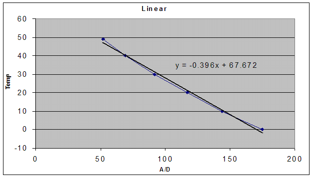

At the low end of the temperature scale the A/D value can be up to 175 (0 deg.)What would be the difference if you change the TempC = DIV32 1000 for this: TempC = TempC / 1000 ?
If you multiply that times 396, the result is 69,300. That's over 65,535, so the result of the normal divide would give an incorrect answer.
It has to be DIV32.
