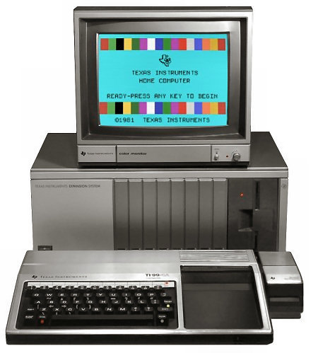

    But erm...
    CounterA=0 : CounterB = 1234 : TRISB = 0 : OPTION_REG=%10101010 : LCDOUT $FE,1,"Hello dear!" : Gosub KindaLongLine : IF A=0 then : V=1234 : ELSE : q=908 : ENDIF : GOSUB ItsReallyReallyLongNow : PORTA=128 : PORTC=144 : PAUSE 150 : I2CREAD SDA, SCL, ControlByte, Address, [$FF,$EA, 1,2,3,4,5,6,7,8,9,CounterA, CounterB,0,0,0] : LCDOUT $FE,$C0,"Ok i think you see the picture now" : Gosub OKImDone ' Startup thingy :o)
    that's a bit too much, not sure if it compile anyway
    I don't remind if that syntax was available on that one... ;o}
    That's the whole kit with the speech synthesizer module, but without the tape deck... nostalgic now :-(

    Default Re: TRS80
    I agree, in general it's a good idea, but like beer, when used with moderation
    [/img]
    I never could get one of those to work . . . could't find the ANY Key
    EDIT: DOH TI90 either
