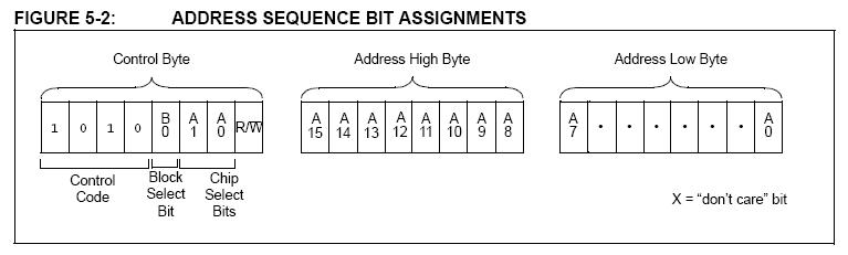

    Hi. Can anybody please explain (with source code if possible) how to access memory over 65535 (I can't use the 24lc1025 over 65535) and how can I append data to the memory (if I switch off the power and turn it back on I want to know where to continue from).
    <IMG SRC="http://www.picbasic.co.uk/forum/attachment.php?attachmentid=1748&stc=1&d=118207160 5">
    In your code you should be able to modify bit3 of your control byte OR you could use 2 different constant
    Block0 CON %10100000
    Block1 CON %10101000
    and later you just need to use the according constant
    I2CREAD SDA,SCL, Block0, Addr,[YourVar] ' read from Block0
    I2CREAD SDA,SCL, Block1, Addr,[YourVar] ' read from Block1

    Thanks, but can you please provide me with some code that actually writes to PIC's EEPROM the location where it should continue from, and the one with addressing over 65536 (since this part I didn't really get it)

    I think something like that have to work
    <font color="#000000">Address     <font color="#000080">VAR WORD
    </font>OldAddress  <font color="#000080">VAR WORD
    </font>ControlByte <font color="#000080">VAR BYTE
    </font>Block0      <font color="#000080">CON </font>%10100000
    Block1      <font color="#000080">CON </font>%10101000
    Address=0
    ControlByte = Block0
    Start:
        <font color="#000080">I2CWRITE </font>SDA, SCL, ControlByte, Address, [0]
        <font color="#000080">PAUSE </font>10
        OldAddress = Address
        Address = Address + 1
        <font color="#000080">IF </font>Address&lt;OldAddress <font color="#000080">THEN      </font><font color="#008000">' Overflow?
                                        ' ----  YES
            </font><font color="#000080">IF </font>ControlByte=Block0 <font color="#000080">THEN  </font><font color="#008000">'       Are we in Block0?
                                        '       ----  YES
                </font>ControlByte=Block1      <font color="#008000">'               Switch To Block1
                </font>Address = 0             <font color="#008000">'               Start at first address
                </font><font color="#000080">ELSE                    </font><font color="#008000">'       ----  NO
                    </font><font color="#000080">STOP                </font><font color="#008000">'               EEPROM is full..
                </font><font color="#000080">ENDIF                   </font><font color="#008000">'
        GOTO </font>Start
    Now you just need to keep track of ControlByte and Address values.
    HTH
