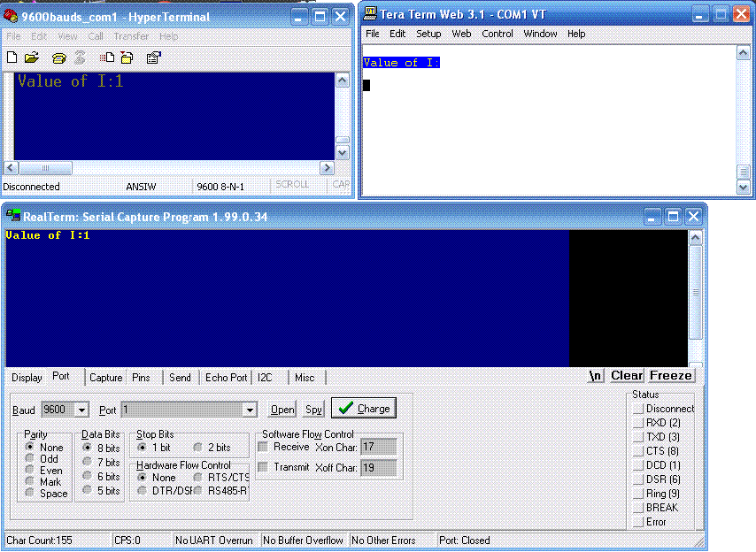

    Anyhow, proof it's working...
    I prefer RealTerm... but... erm, MisterEZCOM is not bad to...
        @ ForColor yellow               ; Set foreground (text) color to yellow
        @ BackColor blue                ; Set background color to blue
    loop:
        @ ClearScr ; Clear Screen
        HSEROUT ["Value of I:",I,10,13]
        HSERIN [i]
        GOTO loop
    Feel better now ?
