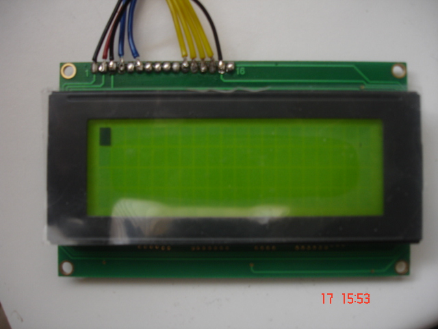

    i have a 4x20 line lcd display with a program to say hello world.
    when the program is run it just shows up as a small block in the top left corner
    when the capacitors each side of the crystal are removed (2 x 33nf) it shows up as 2 lines of blocks
    can some one tell me why it is doing this and not displaying my text?

    Code? 1-2 second pause after startup to let the LCD startup? Contrast voltage is obviously set ok.

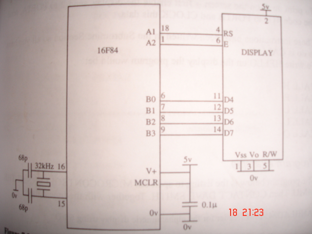

    If you post a SCHEMATIC of how you've got your hardware connected, along with the PIC you're using, I'm sure someone on this forum could throw a few lines of code together to write to your LCD and perhaps also flash a confidence LED to prove your hardware is working and post you a HEX with which you could program your PIC. That at least would prove if it's your hardware or software that's causing you grief. Then you could buy PICBasic and become a fully paid-up member... gives you status... people give up their seat for you on the bus... women will want you to kiss their babies (or claim you're the father)... you can run for president... etc etc...
    Jun 2007
    19
    the schematic is in the pic below, the only difference in my circuit is that i am using a 4 MHZ crystal instead of 32khz, i have compensated for this in my code, correct me if i am wrong.

    There's still some mistake in your code so far... not sure it's working @32KHz anyways
    V0 to to GND? not sure, should be connected to a POT wiper or PWM driven or voltage divider.

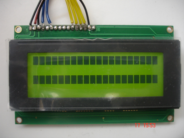

    cheers malcom, thats now worked, downloaded the hex on to my PIC.
    But still having problems, only showing line 1 and 3 full of solid blocks.
    My .ASM will work... but Melanie's Example is setuped for a 2 LINES LCD
    so just change the following
    	Define LCD_LINES 2			' Using 2 line Display
    to
    	Define LCD_LINES 4			' Using 4 line Display
    OR use the corrected .HEX in attachment

    19
    cheers mister e, just found out it was a problem with my code as i am fairly new to it, but i went over my circuit with a fine tooth comb, litteraly,
    using a magnifying glass i was able to just make out a solder bridge between pin 6 and the data lines next to it which are grounded, therefore was not getting a signal. this will have only happend after i grounded them as mel said in an earlier post, as they had not been toutched previousley.
    cheers every one for your help and for putting up with me.
    dont worry i aint running away, ill be back soon to annoy every one again, haha
    does any one know any sites with information on so i can learn how to program more in that language?
    thanx
