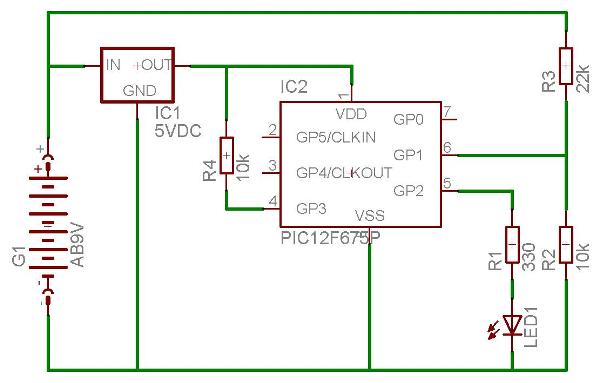

    Okay, after some more trials and a correct connection to GP1 (... not GP0!!!), I got it working.
    BUT how do I improve the accuracy?
    When the measured voltage ist between 2,3V and 2,6V, my led flickers.
    How do I fix this?
    Another strange thing: if I "forget" to set the GP1 input as Analog (ANSEL), it still works(!?).
    BTW, here are my corrected schema and code:
    <img src="http://www.picbasic.co.uk/forum/attachment.php?attachmentid=1708&stc=1&d=118097654 5">
    ' Fuses
    @ DEVICE PIC12F675,INTRC_OSC_NOCLKOUT ;Internal oscillator 4MHz
    @ DEVICE PIC12F675,WDT_OFF
    @ DEVICE PIC12F675,PWRT_ON
    @ DEVICE PIC12F675,MCLR_OFF
    @ DEVICE PIC12F675,BOD_OFF
    @ DEVICE PIC12F675,PROTECT_OFF
    @ DEVICE PIC12F675,CPD_OFF
    ' Registers    76543210
    OSCCAL      = %10000000 'Center frequency - used with Internal 4MHz OSC
    TRISIO      = %00000010 'Set Input/Output
    GPIO        = %00000000 'Ports High/Low
    WPU         = %00000000 'Weak pull-ups (check OPTION_REG)
    OPTION_REG  = %10000000 'Pull-ups / Interrupt / Prescaler
    ANSEL       = %00000010 'Analog I/O
    CMCON       = %01000100 'Comparator Module settings
    VRCON       = %10101100 'Voltage reference (= 2.5V)
    ' Variables
    BatVal   var CMCON.6
    BatLoLED var GPIO.2
    ' Program
    Pause 1 'Delay to allow for VREF to settle
    MAIN:
        BatLoLED = BatVal
        pause 10
        Goto Main
