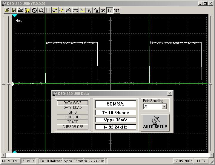

    While making some experiments, I notice that changing the dutycycle will affect the Period's duration (frequency).
    First, I set dutycylce to 127 (=50%). The frequency is 92,24kHz.
    <img src="http://www.picbasic.co.uk/forum/attachment.php?attachmentid=1640&stc=1&d=117939319 7">

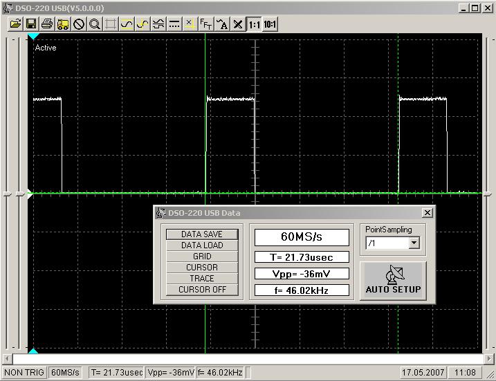

    Second, same test at 64 (=25%) dutycycle. The frequency is now 46,02kHz.
    <img src="http://www.picbasic.co.uk/forum/attachment.php?attachmentid=1639&stc=1&d=117939319 7">
    In my comprehension of PWM, dutycycle would affect only the ratio of the HIGH against the LOW signal.
    Is this okay or am I measuring something wrong?

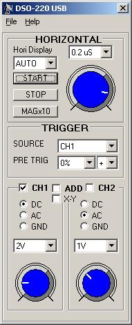

    Triggering parameters and signal amplitude ... please !!!
    36 mVPP looks like the scope is set in AC mode.

    And here is how the oscillo is set:
    <img src="http://www.picbasic.co.uk/forum/attachment.php?attachmentid=1649&stc=1&d=117941075 3">
