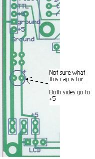

    Just concentrating on the Power&Ground right now.
    <img src=http://www.picbasic.co.uk/forum/attachment.php?attachmentid=1578&stc=1&d=117761534 8>
  17. #137
    mmm nice catch!
  18. #138

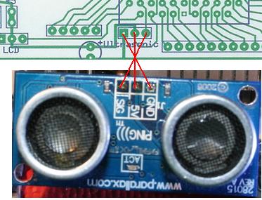

    I think the PING's backwards too.
    <img src=http://www.picbasic.co.uk/forum/attachment.php?attachmentid=1579&stc=1&d=117761982 8>

    i have never had this many problems with my boards... i have fixed everything that was mentioned... i took out that cap, increased the sizes of power and ground traces (and made them go all around the board), and i flipped the "ping" around too..
    i dont know how i got that one backwards, it was fine all the other times i designed this...
    thanks guys....
