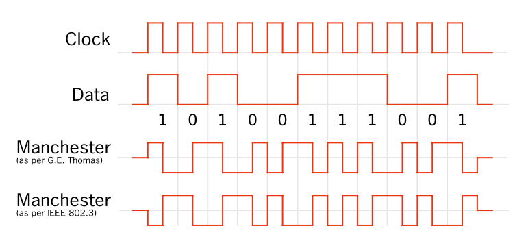

    Without going into much technical blah... blah.. (Which I don't understand )
    Skimask please correct me if I am wrong as I have never used a Tx/Rx module.
    Your Tx and Rx module uses ASK (amplitude shift keying). This is the most frequent and low cost. It means that your receiver demodulates the signal by finding a difference of the transmitted carrier level. Now take for example that you need to transmit 255 = b'11111111' . For 8N1 you would actually set the output (carrier) high for the start bit and since all of your bits are high through the ending stop bit you would be keeping it high for the entire byte. This is NRZ (Non return to Zero) and drives your receiver nuts and it cannot see a practical shift in the amplitude.
    Thus comes manchester to the rescue. It ensures transition for every bit. It is used for automatic clock recovery but here it eases the ASK demodulation.
    If you are sending only a specific byte, (if the sending is in your hand) then you can actually use shifting 1s. Guess what you get at the receiver side ? I will leave that for your research
    Sougata
