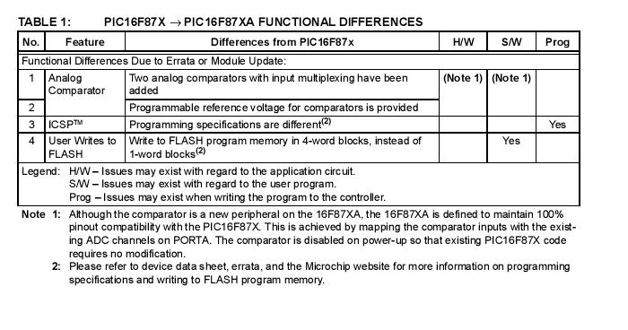

    I also have the same problem,i have a code compiled for pic16f877
    the data,clock pin is on porta pin,when i program it on pic16f877a i did not work.
    how would i disable the comparator.
    Comming from the migration sheet...
    <img src="http://www.picbasic.co.uk/forum/attachment.php?attachmentid=863&stc=1&d=1146485135 ">
