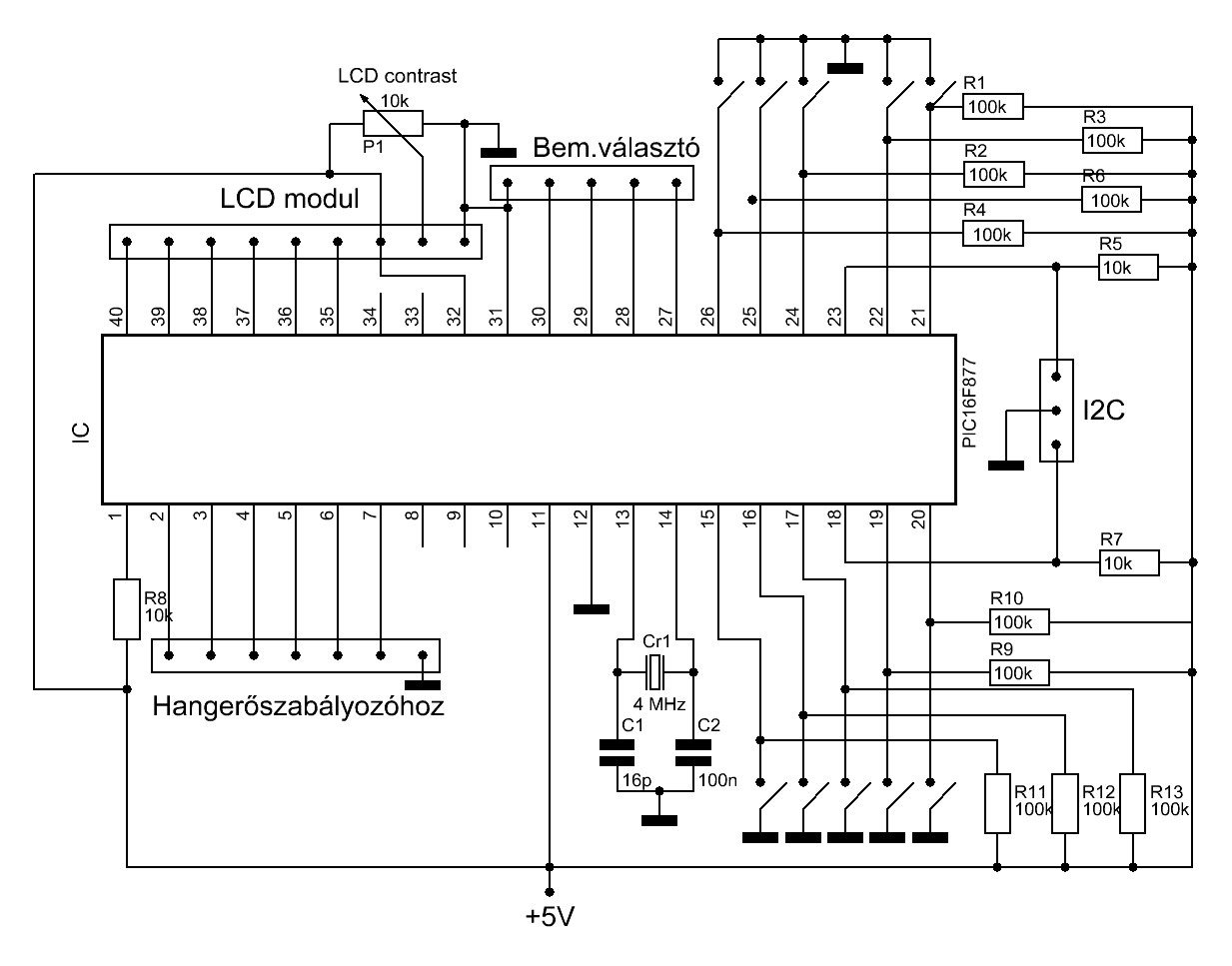

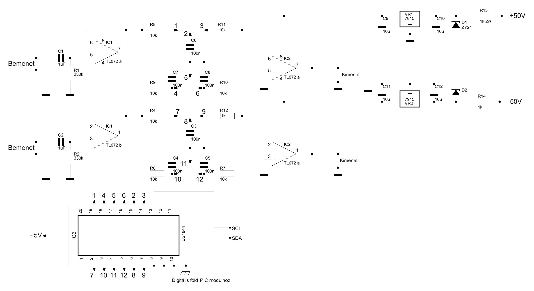

    Hi!
    I am working on a digital amplifier project with DS1844 digipot but the I2C communication don't work.
    I use PIC16F877A, SCL is PORTC.3 and SDA PORTC.4 with 10k pull-up resistors. (also I tried with 4,7k)
    The control byte is 01010000, A0, A1, A2=0; PS=1

    Jun 2007
    6
    Yes, I have 4,7k pull-up resistors
    Already I've tried check, but I hadn't found nothing mistake.
    Yet I will to try
