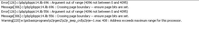

    I am using a 16F690 with 4K word of code space and am running into an issue using more than 4 lookup tables with 255 values each.
    I am compiling to 2652 words, but the compiler is spitting out errors like mad. I have searched like mad on the forum for a workaround but I am not having any luck..
    if I back down to 4 lookup tables the errors go away.

    Default Compilation Errors
    here you go

    Default Are you using any org directive
    It seems that the code is compiling past the maximum available memory. The warnings should not cause panic. Have you tried using MPASM ?

    I am compiling using MPASM in Microcode Studio with PBP 2.47
