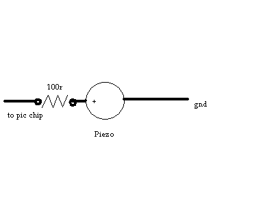

    here is some working picbasic pro code
    these sounds wont be like a gong but all
    you have to do is change the numbers to
    suit,it works in pairs for example
    SOUND PORTb.1,[100,10] sends tone 100
    to portb.1 for a duration of 10ms
    target prosesor is 16f628-a
    cmcon = 7 'turn compartors off
    vrcon = 0 'turn voltage refrence off
    define osc 4 'set oscillator speed
    finaly:
    SOUND PORTb.1,[100,10,60,15,120,10,73,10]
    pause 400
    SOUND PORTb.1,[120,10]
    pause 400
    pause 400
    goto finaly
