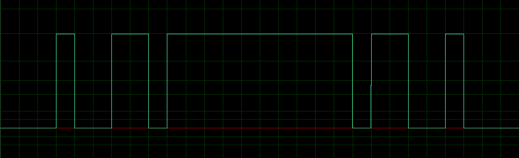

    What I actually want to do is this: (see picture)(strongly abbreviated)
    Down means LED is off, Up means LED is on. The x-axis represents time.
    So it is a LED light - fader.
    So time could be 100ms meaning the LED is being switched on successively in a repeating manner till it will have taken 50ms then the process is reversed amounting to a total of 100ms.
    Can you suggest a code for this?

    First of all you have good English. We are talking about one led fading in and out which is being repeated. Imagine a flashing led. Now imagine the led is on. Imagine it not being on instantly but having an increase in brightness. Then imagine it having a decrease in brightness. Increase and decrease amount to flashing time. It softens the led's appearance.

    But imagine there is a servo motor. The motor needs a signal every 20ms to keep it's torque. So the interrupt starts the interrupt routine. The interrupt routine should take say 2 seconds. And within these two seconds there is the action of force onto the motor.
    This is what I was alluding to when writing about the pauseus issue. This stands for reserving time within the interrupt routine.
    Or do DT's includes make the pic execute the code (even the main code) by cycling through each interrupt each cycle of code execution? So using a 20Mhz quarz leads to processing a portion of each code every 0.2 us?
    I appreciate that you want to answer my questions to my satisfaction. Then give me a code example showing how to do that with DT's includes.
