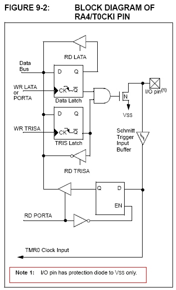

    Default Which PIC, any open drain outputs ?
    Some PICs have an open drain output (say PORTA.4). This means that it has only the lower side N-Channel MOSFET inside. And according to a Microchip FAE this can tolerate upto 8 volts safely. Hopefully it should not be a problem with your buzzer and 9v battery.
    Sougata
    You're right, it does say that. But it also says that PORTA.4 has protection diodes to VDD and VSS.
    Which one are we supposed to believe?
    I suppose a little testing would tell.
    Figure 5.4 in the datasheet for the 16F628 shows no clamp diode to VDD.
    Paul Borgmeier
    Salt Lake City, UT
    USA
    __________________
    This figure 5-4 ?

    Default Then what is this ??
    This one is from a PIC18F452 datasheet page 90. Note that I/O pin has protection diodes to VSS only.
    Sougata
    4,184
    Darrel, take a look at Mid-Range Reference Manual for 16 series. At page 145, Figure 9-3 it clearly states that clamp diode is only to Vss. It could not be otherwise for higer voltage connection. So I suppose the 5-4 you posted might be wrong.
    EDIT: Damn, Sougata just got me for a few msec...!
    Exclamation
    Hmmm, well I guess it depends on which PIC you are looking at.
    manumenzella never specified. And the original post regarding RA4 as much as assumed they are ALL like that.
    Paul was referencing the 16F628, which according to the most recent datasheet, Has the diode.
    If you look at a 16F628A, then it doesn't.
    If you look at the 18F452 datasheet from a couple years ago, it says it does, but the most recent one doesn't.
    Was it a change in the datasheet, or the silicon?
    Like my original comment,
    "Which one are we supposed to believe?"
    Personally, I'd go with the transistor.
    <br>
