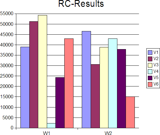

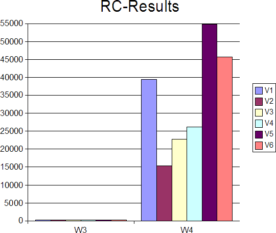

    Dear readers,
    I have attached a RC connection to a Microchip's pin.
    Pin ---- 0 to 40 kOhms ---- 100 nF ---- GND
    1. Make Pin high
    2. Let wait for 20 ms
    3. Set pin to high-impedance
    4. I let wait, till pin Low becomes low - counting while doing so
    Depending on R value it is faster/lasts longer to make pin Low.
    I make the value of R be constant and do several measurements. The result is visualized for me.
    What can I infer from these values ?
    W1:
    	ADCWert = 0                   ;I
        TRISA.3 = 0
        PORTA.3 = 1
        Pause 3
        ;PORTA.3 = 0                   ;II
        TRISA.3 = 1
        WHILE PORTA.3 = 1
            ADCWert = ADCWert + 1
        WEND
        TRISA.3 = 0                   ;III
        PORTA.3 = 0
        Pause 18
    W2:
        ADCWert = 0
        Low PORTA.3 ; Discharge cap to start
        Pause 10 ; Discharge for 10ms
        RCTIME PORTA.3,0,ADCWert ; Read potentiometer on Pin3
    W3:
    	ADCWert = 0                   ;I
        TRISA.3 = 0
        PORTA.3 = 1
        Pause 3
        ;PORTA.3 = 0                   ;II
        TRISA.3 = 1
        WHILE PORTA.3 = 1
            TRISA.3 = 0
            PORTA.3 = 0
            TRISA.3 = 1
        WEND
        TRISA.3 = 0                   ;III
        PORTA.3 = 0
        Pause 18
     W4:
    	ADCWert = 0                   ;I
        TRISA.3 = 0
        PORTA.3 = 1
        Pause 3
        ;PORTA.3 = 0                   ;II
        TRISA.3 = 1
        RCTIME PORTA.3,1,ADCWert
        TRISA.3 = 0                   ;III
        PORTA.3 = 0
        Pause 18
