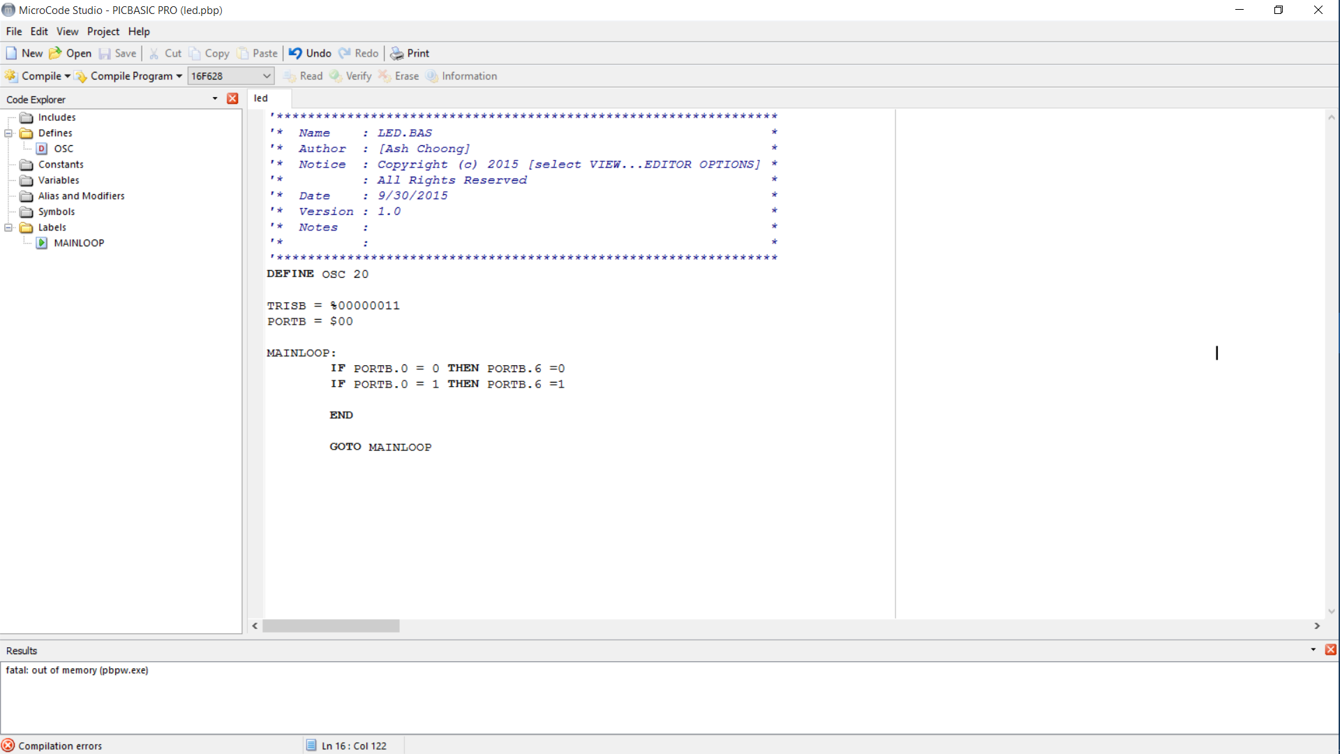

    fatal: out of memory (pbpw.exe)
    I has changing the directory where the source code to one closer to c: (root), hut still can't work
    Attachment 8063
    Wow Winchester, I have no real answer for you but I have an observation, look at the error message where it says line 16 col 122 . . .
    there is something in that spot, maybe you should delete?

    That's not part of the error message, it just tells you where the cursor is.
    At first I thought it was the GOTO, outside of the END statement (which probably isn't what you actually want) that caused the error but prior to posting this I tried it my end it compiles just fine.
    Default Re: Compilation Error
    Yup, Heinrik You're right on both counts, and it compiled for me too, maybe he needs to reinstall or give the program better permissions, or use compatible mode.

    I see this every once in awhile, but not since I upgraded to more memory. Shutting down and rebooting always fixes it. I suspect the program has a minor memory leak.
