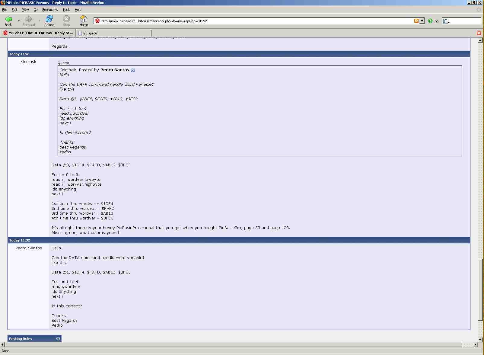

    And man oh man, did I screw up my example above in post #2... If you'll excuse me for a moment, I'm going to go outside and kick my own a$$...

    Could you get someone to take a picture of that?
    Just thought it might Brighten somebody's Day.
    <br>
    I think I'm allowed that one. Maybe not.
    How's this one for ya?
    And besides, I get to drive from here to Tucson tomorrow morning... 58 miles from Canada to 58 miles from Mexico, one end of the country to the other.
