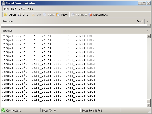

    I changed to ADCON0.7 = 1 and the values I read look much better. Still the Temperature value has to be divide by 2 to give the correct reading.
    Name:  Correct values.jpg
    Even if it's not the main subject here, can you shortly explain what the difference between ADCON0.7 = 0 and ADCON0.7 = 1 is?

  4. #44
    Jan 2013
    Texas USA
    229
    Default Re: 16f877 with LM335 problem
    Roger,
    Check out section 9.1.6 "Result Formatting" of the Datasheet.
    It shows the difference in the two formatting options.
    In essence Right Shifted will place the 10-bit value in bits 9 through 0 (MSB is bit9).
    Left Shifted will place the 10-bit value in bits 15 through 6 (MSB is bit15)
    So if your ADC reading is 250 then here would be the values.
    Right Shifted = 250 (%0000 0000 1111 1010)
    Left Shifted = 1600 (%0011 1110 1000 0000)

  6. #46
    4,175
    If you want to use only 8 bit (may be it is enough for specific application) then the left justified result will give yout the number in the ADRESH directly. No shifting or dividing required.
    But for the full 10 bit results you have to right justify the bytes in the ADRESH-ADRESL to be correct.
