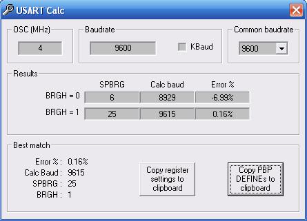

    I also agree with the BRG setting, so i guess you wasn't aware of the PICMultiCalc?
    <img SRC="http://www.picbasic.co.uk/forum/attachment.php?attachmentid=1310&stc=1&d=116776697 4">
    Just click on the Copy PBP DEFINEs to clipboard button and paste the settings in your code. This software choose the best setting for you. Don't have to worry about using your calc or the datasheet Tables.
    The software is always available Here and it's free.
