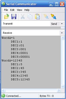

    I am trying to figure out what the command Dec2 and dec1 means,
    They are just mentionned in the picbasic pro manual, but they are not comment. I seen them in programs, but I do not know what it does, Could someyone tell me what it mean.

    See this example on MELAB's website - your questions should be clear after that
    http://www.melabs.com/resources/samples/pbp/ser2mod.bas

    DEFINE OSC 20
    DEFINE HSER_SPBRG 129 ' 9600 Baud @ 0.16%
    WordA var word
    Start:
        worda=1
        gosub sendit
        worda=12345
        gosub sendit
    Spin: goto Spin
    SendIt:
        hserout ["WordA=",dec worda,13,10,_
                 "     DEC1:",dec1 worda,13,10,_
                 "     DEC2:",dec2 worda,13,10,_
                 "     DEC3:",dec3 worda,13,10,_
                 "     DEC4:",dec4 worda,13,10,_
                 "     DEC5:",dec5 worda,13,10]
    <img src="http://www.picbasic.co.uk/forum/attachment.php?attachmentid=1281&stc=1&d=116641400 5">
