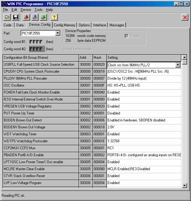

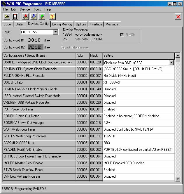

    And you can configure PORTB as digital in your config fuses with the right setting
    _PBADEN_OFF_3H      ; PORTB<4:0> pins are configured as digital I/O on Reset
    _PBADEN_ON_3H       ; PORTB<4:0> pins are configured as analog input channels on Reset
    OR use
    ADCON1=$0F
    CMCON=7
