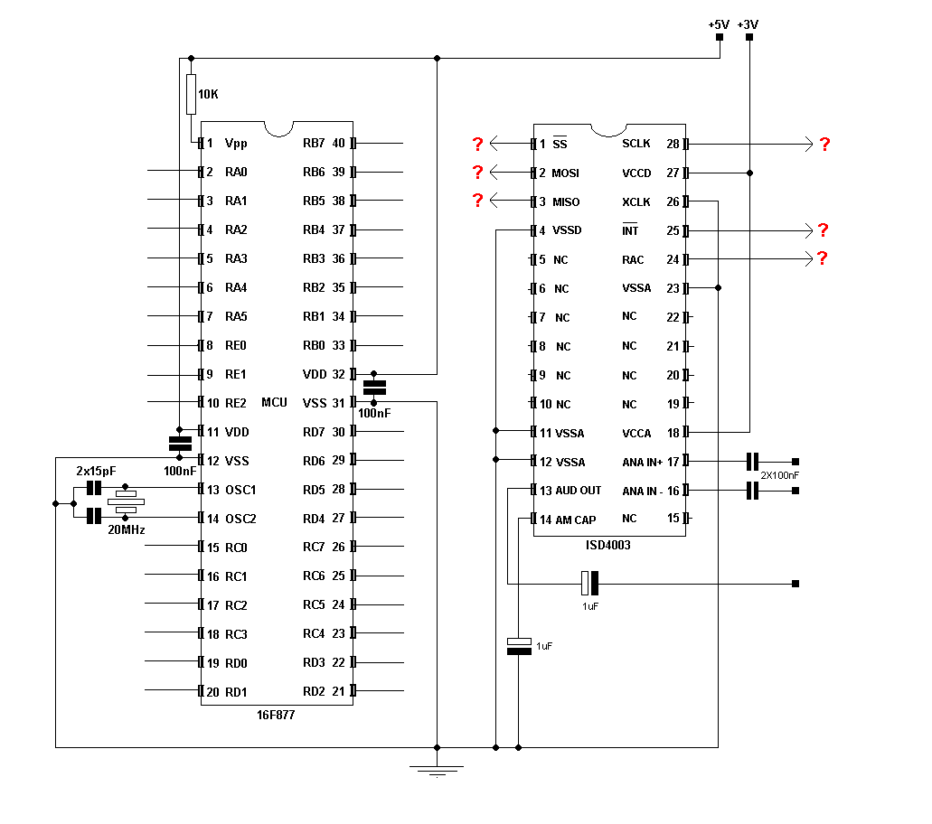

    I have this code from melabs.
    Referring to this code, can someone please complete the schematic for the correct connection between these two chips, ISD4003 and F877?

    My problem is with RAC, INT and SS pins of the voice chip.
    Where do they go on PIC? (with this code).

    Hi, Sayzer
    May be you've noticed there are 2 Sheets in the LabXT Scheme ...
    The 877 is on the first one and the 4003 on the second one.
    All pins are clearly labelled ( Voice int and Select voice ...RAC is left floating )

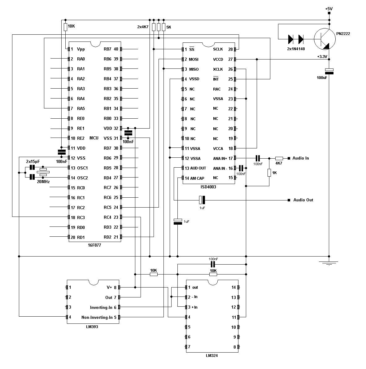

    I did not notice that Alain.
    I must be in a different world when I wake up.
    Now, the schematic has become as this one so far.
    I now need to figure out the code for ISD4004 instead of ISD4003.
