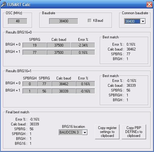

    Default Re: New PIC Utility. PICMultiCalc
    PICMultiCalc gets runtime errors in windows 7.
    Is their a newer version than 1.3.1?
    This is a much used utility and an update would be appreciated.
    Norm
    3,626
    Hi Norm,
    I run it on Win7-64bit and don't get any runtime (or other) errors. I don't know what version I'm running but I can check tonight. If you haven't already tried it, try running it as administrator and see if that help. I've had several apps where doing that is neccessary for it to work.
    440
    Hi Norm,
    ...try running it as administrator and see if that help. I've had several apps where doing that is neccessary for it to work.
    Running as administrator didn't help in 32 bit windows 7 professional.
    I have the following NET's installed by default in case this is a Microsoft VB supportive files issue:
    Microsoft® .NET Framework Version 2.0.50727.4927
    Microsoft® .NET Framework Version 3.0.6920.4902
    Norm
    I had to download & install Microsoft ActiveX control Pad to get LCD tool working.
    I had to download & register MSSTDFMT.DLL to get Timer tool working.
    All tools worked after that.
    Nice utility, I had the old SPBRG version.
    If you get this in Win 7 64bit:
    ActiveX Control Pad Setup:
    the app was unable to start correctly (0xc0000142)
    Run in XP compatibility mode.
    To register MSSTDFMT.DLL in Win 7 64bit:
    - download the file from microsoft.
    - copy to C:\Windows\SysWOW64 folder
    - RUN REGSVR32 C:\Windows\SysWOW64\MSSTDFMT.DLL
