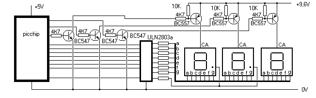

    Hi everyone,
    I made a 4 digit LED clock using 4, 7segment common anode displays of 1 inch size.
    Now i want to make a bigger one using 2.3inch displays.
    But these 2.3 inch displays require more than 9.6v to function.
    Since i am multiplexing the 4 displays, i need to control the 8 cathodes (which are in parallel) and the common anodes. But these anodes require 9.6 volts.
    But the pic can supply only 5 volts. How should i make the circuit so that it supplies 9.6 volts to the displays???
    Can anyone please help me?

    A concept as below could work, I think.
    It is just a concept though. Can be modified for anode / cathode path.
    You will need 8-transistors + 4 for the common ones.
    ULN type of drivers could be handy here, but you need to make use of them with respect to anode/cathode issue.

    This will not work.
    The transistor will work as a emittorfolower and the voltage on the emittor will not come over 4,3 volt.

    The schena above is still not ok.
    Her an example how it should work.
    From Darrel:

    Here another try for the diagram.

    No. The 4011 will still be connected to the 5v supply so the PNP will always be driven as its base will not be allowed to go to 9.6v to turn off.
    You could use a chip with open collector or open drain outputs. Another ULN2803 would do the trick but would occupy about the same space as the three resistors and NPN transistors it replaced.

    As Keith said, you will most likey have to use two ULN type of drivers.
    Thats seems to be the way.
    Also, why not consider mat's schematic?
    Or if you have limitations, why not try finding Big Led displays with 5V, if there is any?

    Will also work on 12 volt, 15 volt.
    I cannot open your schema. There is something wrong with the server I think. Because I could also not upload my diagram's like that, so I post them somewhere else, and gave a link to this forum.
    shahidali55, Why not just use a UDN2981 for the sourcing driver as it is a direct connect to the PIC?

    That is indeed a nice ic, also for this solution as the CA driver. But you will lose about 2 volts over the internal output transistor.
