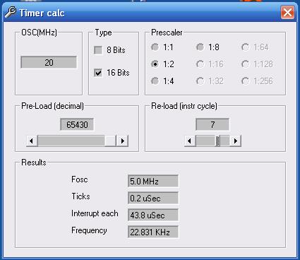

Variable PRESCALER is used to load TMR1
if PRESCALER = 65430 output frequency is 19.85 KHz
if PRESCALER = 65431 output frequency is 19.85 KHz
if PRESCALER = 65432 output frequency is 19.85 KHz
if PRESCALER = 65433 output frequency is 20.83 KHz !!!!!!!!!!!!!!!!!!!!!!!!!!
if PRESCALER = 65434 output frequency is 20.77 KHz
if PRESCALER = 65435 output frequency is 20.77 KHz
if PRESCALER = 65436 output frequency is 20.83 KHz
if PRESCALER = 65437 output frequency is 20.83 KHz
if PRESCALER = 65438 output frequency is 21.74 KHz !!!!!!!!!!!!!!!!
if PRESCALER = 65439 output frequency is 21.74 KHz
if PRESCALER = 65440 output frequency is 21.82 KHz
Can someone please explain me why I get 1 KHz frequency gaps ? Is this normal?
