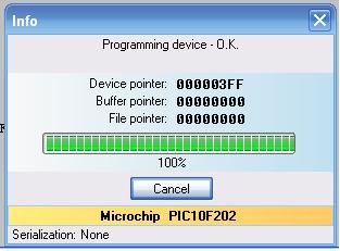

    Hey - copied it all across and it compiled thanks - however - it won't program :s
    "ROM programming error at address 0x0000
    Good 0x0025
    Bad 0x0FE7"
    Any ideas on what that could mean?

    One thing that strikes me as odd is that when you look at the hex file im my programmer it's in groups of 3 instead of groups of 4 - any clues why?
    This programming error message seems to be popular now. Do a search within the forum or the website of your device programmer AND/OR software.
    Compile and program fine here.

    As mister_e mentioned, it is a popular error. You seem to be having a low voltage issue on your programmer.
    If you can, try a simple code on 12F508.
    If you get the same error then you definitely have a low voltage issue.
