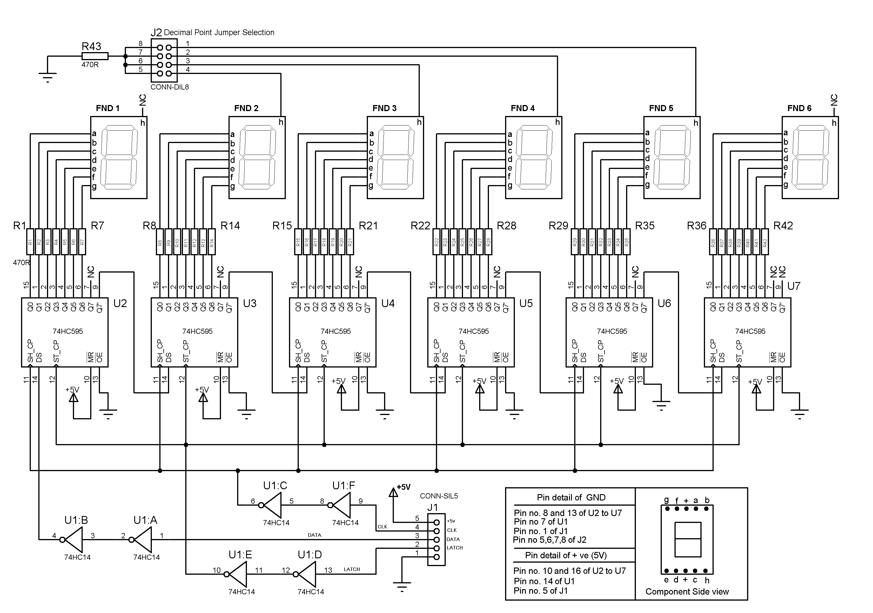

    Hi all
    I am using 900 ppr encoder for length measurements. i using 595 chip to show display and rs232 output for x,y plotting. when encoder rotate on 5 rpm, it is work. But when encoder run above 5 rpm, pulses are missing.
    Where my codes are wrong ?

    You are getting the same problems here under this post;
    http://www.picbasic.co.uk/forum/showthread.php?t=4610
    Check the links and the suggestions...
    Regards.

    Hi sayzer,
    Thanks for the reply.
    But i don't using eny pause in my code. I also using Intrrupt for high age detect from encoder and count.
    Jan 2006
    Istanbul
    1,185
    Np.
    Why don't you use 20Mhz Xtall ?
    Your DEFINE is 12Mhz, are you using 12Mhz Xtall ?
    Regards.
    My rules:
    1. Don't use Serout when the PIC have an internal USART, use HSEROUT instead.
    2. use Timer as counter when hardware allow
    3. keep ISR as short as possible to avoid latency etc etc
    In this case, i guess, you could remove the interrupt and do the job by reading the Timer register. Working 'round the multiple if/then statement you can improve it.

    When you start the PIC and IF PORTA.0=1 you make it jump to the ISR? Bad practice
