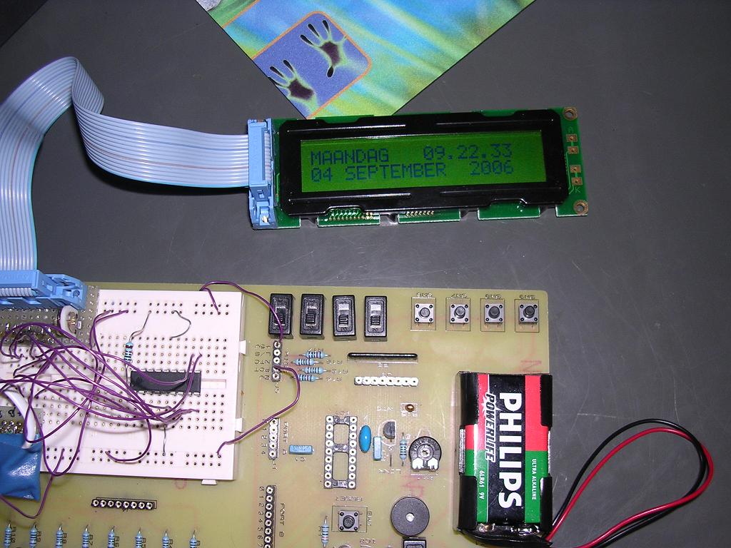

I just made a trial with the software and tested it. Look what happens!
I think you made some typing errors.
