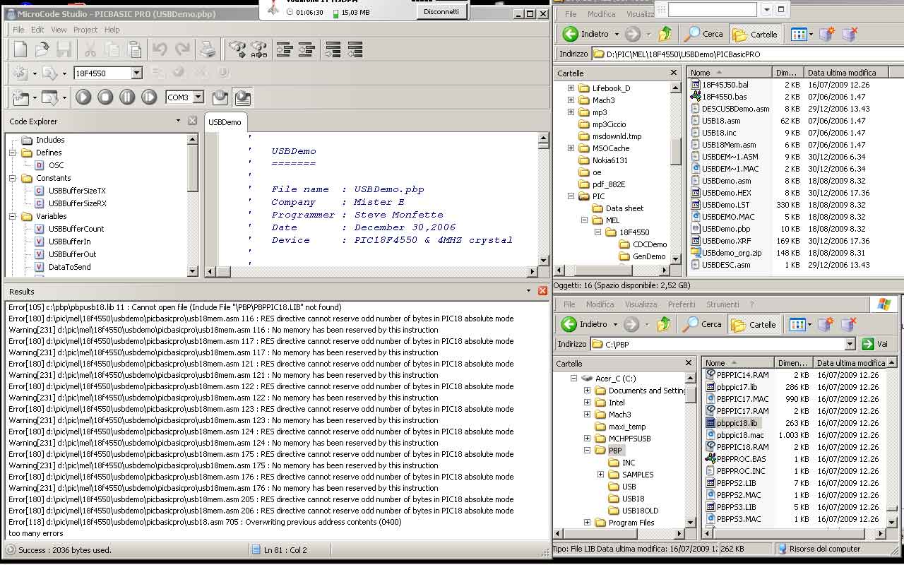

    In the attached screen shot are visible the compiling errors, and the involved directory.

    the "D" is a partition of the main hard disk. No CD are used.
    I have copied into the source directory the following file:
    pbppic18.lib
    18F4550.bal
    PBPUSB18.LIB
    but the compiling errors remain the same.
    Leo
    The first error in the image is from the PBPUSB18.LIB file in your PBP folder, which is installed with this default path to the Library ...
    include "\PBP\PBPPIC18.LIB"
    But if you didn't install it in the default folder C:\PBP, you have to change it to point to the correct location.
    If using PBPL then that line is in PBPUS18L.LIB
    You should not need to copy those files to the project directory.

    but when i compile, I see errors as for the attached screen shot.
    Any idea about the cause of this errors?
    Leo
    Sounds like you haven't commented out the __Config statements in the include file for your PIC. See this post for more details.

    your suggestion is illuminating.
    I have commented the following statement into the c:\pbp\18F455.inc
    ; __CONFIG _CONFIG1L, _PLLDIV_5_1L & _CPUDIV_OSC1_PLL2_1L & _USBDIV_2_1L
    ; __CONFIG _CONFIG1H, _FOSC_HSPLL_HS_1H & _FCMEN_OFF_1H & _IESO_OFF_1H
    ; __CONFIG _CONFIG2L, _PWRT_OFF_2L & _BOR_ON_2L & _BORV_3_2L & _VREGEN_ON_2L
    ; __CONFIG _CONFIG2H, _WDT_ON_2H & _WDTPS_512_2H
    ; __CONFIG _CONFIG3H, _CCP2MX_ON_3H & _PBADEN_OFF_3H & _LPT1OSC_OFF_3H & _MCLRE_ON_3H
    ; __CONFIG _CONFIG4L, _STVREN_ON_4L & _LVP_OFF_4L & _ICPRT_OFF_4L & _XINST_OFF_4L
    and now the compilation go on without errors.
