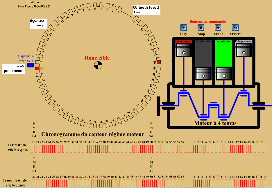

    i want simulate a cycle rpm sensor for automotive.
    http://www.geea.org/IMG/swf/capteur_vitesse_6.swf
    the frequency must be able.
    i ve test this code (!!! it s not the same cycle of the picture)

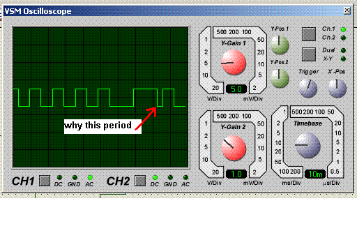

    but why on the piture the period after double pulse the low period its not equal w0?
    May 2006
    27
    Default pulse simulation
    help please
    Wink Nothing strange.
    PAUSE Missing after PULSOUT 3, W1
    Goto Pulse instead of Goto Bouton ---- mais à quoi servent donc les interruptions ???
    et on termine en plaçant la visualisation dans le programme d'interruption juste AVANT le Enable !!! ( ça évite les affichages Ollé, Ollé ...)

    I want a double pulse in end cycle but before new cycle , i want simple pediod low but it not equal w0!!!
    May 2006
    27
    I remove lcd and it s ok
