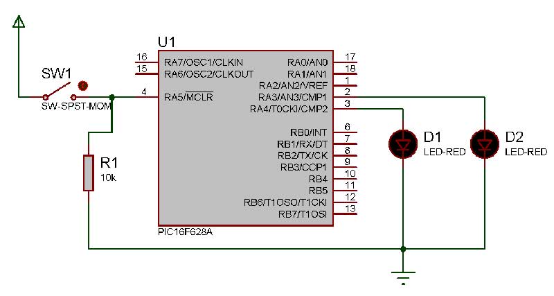

    I just tried the attached circuit with this code:

    and it only lits the led on ra3
    Any idea? Maybe its a simulator issue (proteus vsm)
    PORTA.4 is an open drain type. so you can't really drive it like that... you can drive it low but not high... well not directly.
    BTW you really need to a resistor in serie with your LEDs to limit the current.
    Feb 2005
    130
    Thanks Steve, I changed common cathode for common anode display and now it works as expected!!
