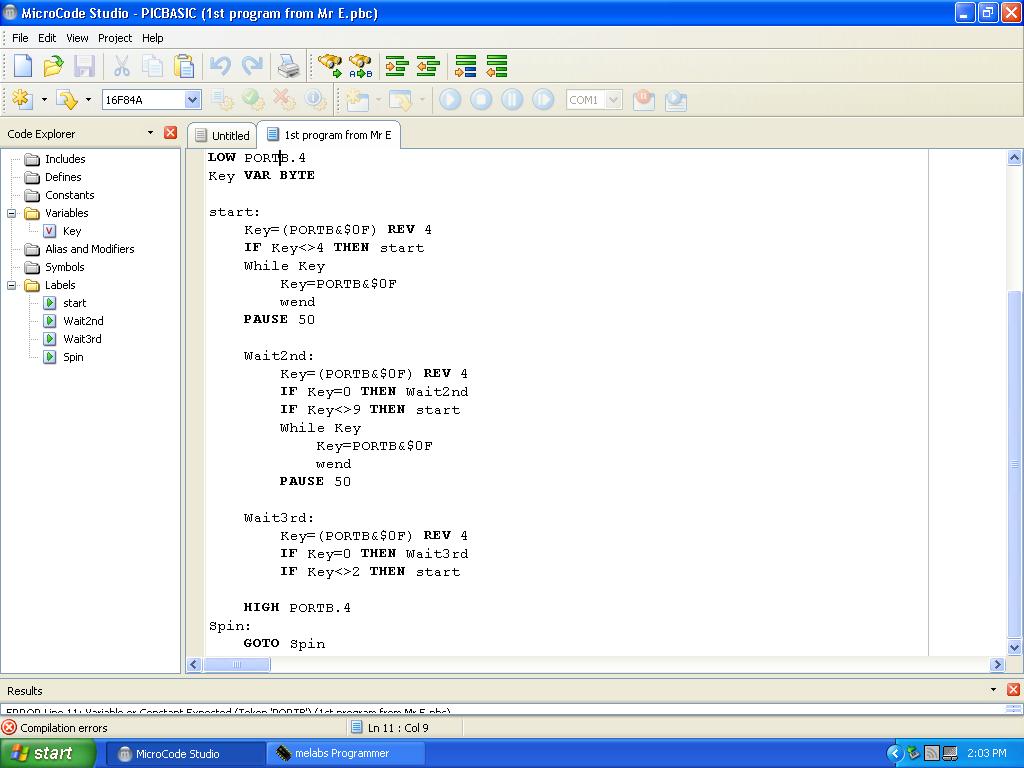

    the most inefficient way but easy to follow.
    LOW PORTB.4
    Key var byte
    start:
        Key=(PORTB&$0F) rev 4
        If Key<>4 then Start
        While key
            Key=PORTB&$0F
            wend
        pause 50
        Wait2nd:
            if key=0 then Wait2nd
            If Key<>9 then Start
            While key
                Key=PORTB&$0F
                wend
            pause 50
        Wait3rd:
            if key=0 then Wait3rd
            If Key<>2 then Start
        HIGH PORTB.4
    Spin:
        goto spin
