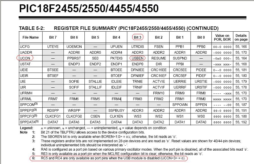

    Now I would like to disable the USB-controller of this pic, because I don't need this feature and I have to use the input pins RC4 and RC5.
    I've read the datasheet and I can disable USB by setting bit3 (USBEN) of the UCON register to zero. The problem is that it looks that PBP doesn't know the commands I want to use. I think i have to use assembly. I tried the following, but I get a warning.

    I also need to add UCON and UCFG for a PIC 18F4550. Adding the variables in the file mentionned above corrects the undefined error at compile time, but how do those variables get linked with the proper registers?
    3,169
    Ruben,
    Unless I am mistaken, the USB module is disabled by default. That's why I need to turn it on for USB processing. If you need to use pins C4-5 as IO, you should not have any problems doing so.
    Or did I read the datasheet backwards?

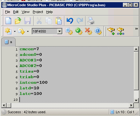

    Setting the ADCON0:2 to registers causes compile errors and warnings
    Setting the CMON register causes compile errors and warnings
    I've even tried cut and pasting the ASM code from the data sheet, but to no avail.

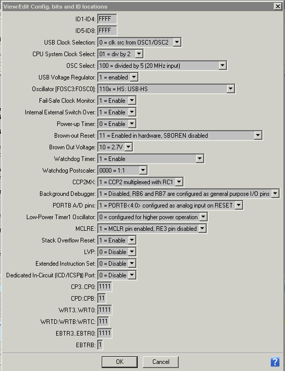

    Here's my CONFIG file for 48MHz USB processing, I commented in all values so that I can easily change things around. The base of this setup came from Bruce's post.

    Ok I found the problem... Sorry for the hassle, but this chip has a few traps man!
    The problem was with the CONFIG statements, I was using Steve's example:
    <b>
    CONFIG FOSC=HS ; Use HS oscillator (20MHZ here)
    CONFIG BOR=ON ; Brown out reset ON
    CONFIG BORV=2 ; Brown out detect voltage=4.5 Volt
    CONFIG PWRT=ON ; Power-up timer ON
    CONFIG WDT=ON ; Watch dog timer ON
    <i>....... etc.......</i>
    </b>
    This would compile ok on its own.
    But as soon as I started to add code (eg CMCON = 7) and the likes I got heaps of Compile errors. (Yes I did delete the _config lines in the 18F4550.inc file!!)
    Anyway I fixed the problem by not using the above asm example but rather this instead. (I found this example in one of Mel's threads not sure where now)

    you didn't read the whole post of the config fuse setting. I found the issue later on the same thread. If you want to use the new CONFIG directive, you MUST set them in the pic18F4550.inc file. As now PBP don't support the new directive... this where the Config file (stated in the thread) where born
    NOW being said... if i use the CONFIG stuff bellow.. in wich i did few error for my own pleasure ..

    if i used the kinda unusefull code bellow
    <img src="http://www.picbasic.co.uk/forum/attachment.php?attachmentid=964&stc=1&d=1152676768 ">
    No error, no nothing.. Config fuses? no problem
    <img src="http://www.picbasic.co.uk/forum/attachment.php?attachmentid=965&stc=1&d=1152676888 ">
    I've heard somewhere that you should change all config fuse to be sure that all will be considered.
    Using the OLD method is still working.. read the config fuse thread, there's @ errorlevel stuff... read it 'till the end

    Ok, now I get it and see it working.
    We modify the 18FXXXX.inc file to set the Config fuses, not in the actual program.
    Cheers Mate
