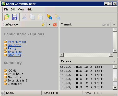

    Or the config fuses are not set correctly, or the OSC speed is not the right one OR the MAX232 circuit is bad OR there's a little hardware problem, OR the serial communicator is not set properly OR all DEFINEs are not written in UPPERCASE.
    Bellow is tested and work on a 16f877.. but it shouldn't make any difference whatever PIC you're using...
    define OSC 12
    DEFINE HSER_RCSTA 90h
    DEFINE HSER_TXSTA 20h
    DEFINE HSER_SPBRG 77 ' 2400 Bauds
    DEFINE HSER_CLROERR 1
    START:
        hSEROUT ["HELLO, THIS IS A TEST",13,10]
        PAUSE 100
        GOTO START
    <img src="http://www.picbasic.co.uk/forum/attachment.php?attachmentid=959&stc=1&d=1152544022 ">
