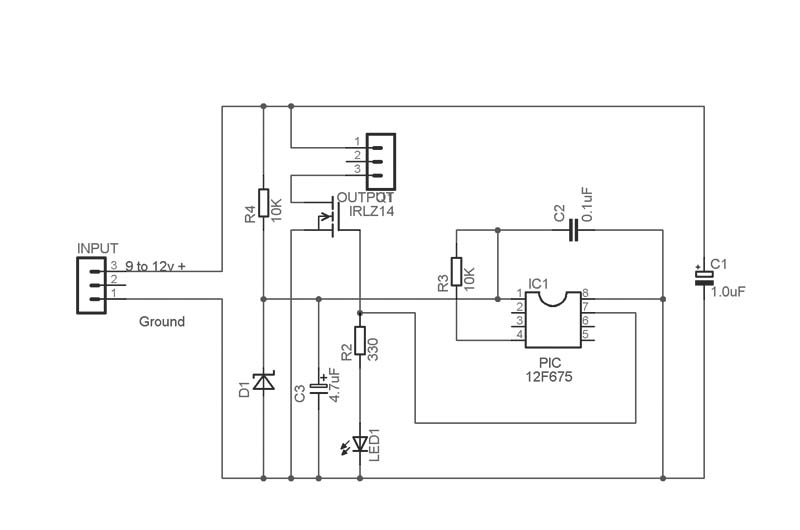

    Thanks mate.. don't waste any more of your time... I've attached the schematic just in case someone might see whats the issue ?
    assuming 12Vin and R4 is really 10K: (12-5)/10K = 0.7mA
    No problem when only the PIC run... but when the LED is attach to.. the voltage will really reduce ... 'till the PIC reset.
    your problem is there, you don't provide enough current, Zener would need at least few mA just for her +Led+Pic... Repace R4 to 200Ohm
    @12Vin : (12-5)/200=35mA
    @9Vin : (9-5)/200 = 20mA
    @12 Vin : 35mA*35mA*200Ohm = 1/4 Watt
    Or better if you replace it for a voltage regulator like 78L05 or any else
    malc-c's Avatar
    malc-c Guest
    Thanks mate for your further help,
    The reason I opted for using a zenner, was the last time I used a 7805 to run a few LEDs the thing glowed trying to disapate the heat !
    I'll see if changing the resistor does the trick
    Malc
    7805 is 1Amp rated
    78L05 ~100mA
    malc-c's Avatar
    malc-c Guest
    Steve, went the hole hog and dropped in a 68R and it works a treat !!
    Thanks for your help
    Cheers
    You're welcome... just make sure that your Zener and resistor are rated to handle it ...
    Resistor 68ohm... (12-5)/68=103mA, 103mA*103mA * 68 = 0.72W => 1 watt
    Zener 5 Volt : 5*103mA = .515 Watt => could be 1/2 watt... i calculate the worst case, VMax,No Load
