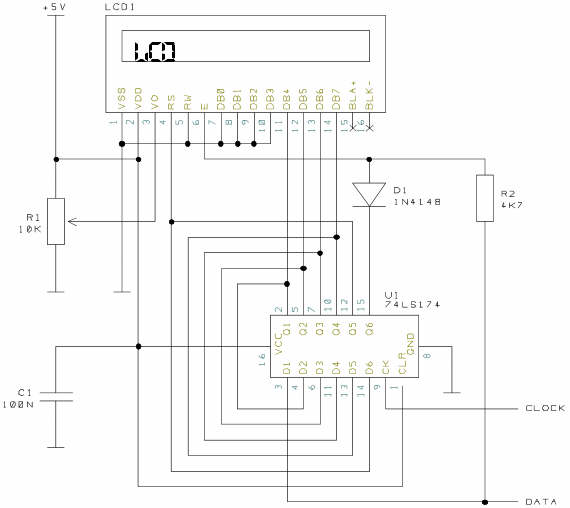

    Talking Serial LCD
    Just wondering if a simple conversion from normal LCD to serial LCD would help you...
    Check out the attachment and tell me if it helps...
    Use an f84 or some rewritable pic just in case...
