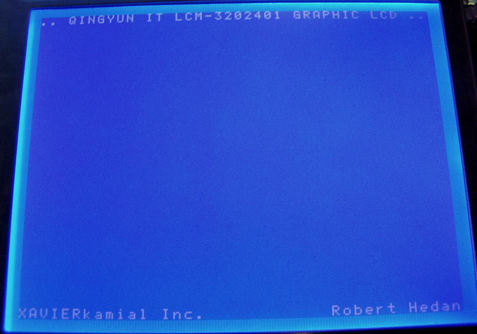

    I thought I'd share the code I've come up with. As far as I know only Compsys has code for this controller, and it is for a smaller size. Since the setting parameters may not be obvious for some (like me, took me forever to figure this out):

    Default Correction To Code
    SendData:
    pinA0 = 0
    pinData = varByte
    pinWR = 0
    @ nop ' <--- ADD
    pinWR = 1
    SendCommand:
    pinA0 = 1
    pinData = varCommand
    pinWR = 0
    @ nop ' <--- ADD
    pinWR = 1
    The [@ NOP] turns out to be very important for high-speed display, it corrects a timing issue. Without it, there is a sort of 'echo' on the LCD when you display characters extremely fast (my initial tests were keyboard-type speeds).
