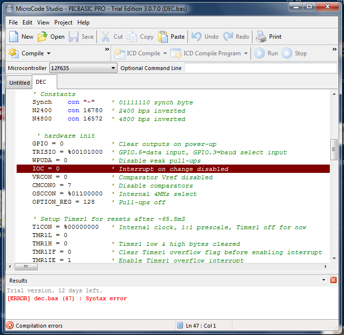

    I have downloaded and ran the PBP3, the latest! I simply wanted to compile Bruce's code into Hex data.
    I supposed opening the code after saving it in a file, select the right device namely pic12f635, and click on compile would work!
    here are the images of some errors

    Thanks again for the reply Robert.
    I think that Bruce's code is a prototype not tested!???
    I haven't undertaken any changes I supposed the code works alright and I wanted to test it at the outset, I thought I would take it as is if it is OK.
    I also learned from here that an A is missing in IOC
    http://www.picbasic.co.uk/forum/showthread.php?t=16819
    I corrected that but still compilation doesn't work.
    I get Illegal Opcode
    If I write it this way:
    @ __CONFIG _MCLRE_OFF & _INTRC_OSC_NOCLKOUT & _WDT_OFF & _BOD_OFF & _PWRTE_ON & _FCMEN_OFF & _IESO_OFF & _WUREN_OFF
    It didn't work either
    I tried the code from there I mean here:
    after adding the A, I still get errors
    Finally
    It only worked once I delete the whole @ _config................... line!
    I have to find out how to edit it properly.

    If you'll look in the PBP3 manual there's a fine example of how to write a config statement. This if for a different chip but you see the context of how it should be written.
    'Config for 16F877A
    __config _XT_OSC & _WDT_ON & _LVP_OFF & _CP_OFF
    Enjoy.

    Are you using PM assembler?
    If yes, make sure to point to MPASM assembler in the Microcode assembler settings.
    It was most likely in the Microcode Studio download or get it here:
    http://www.microchip.com/stellent/id...&part=SW007002

    Quote Originally Posted by AvionicsMaster1 View Post
    'Config for 16F877A
    Enjoy.
    Thanks a lot AvionicsMaster1, I downloaded it and I was busy skimming through things from the beginning like how to enable pull ups etc. because some of my own codes I wrote back in 2008 haven't worked. So I spent the night looking for the new changes in the manual and I had a look on some examples. But thanks to you, you cut the way through for me with the config thing. Now I'm on the right track.
