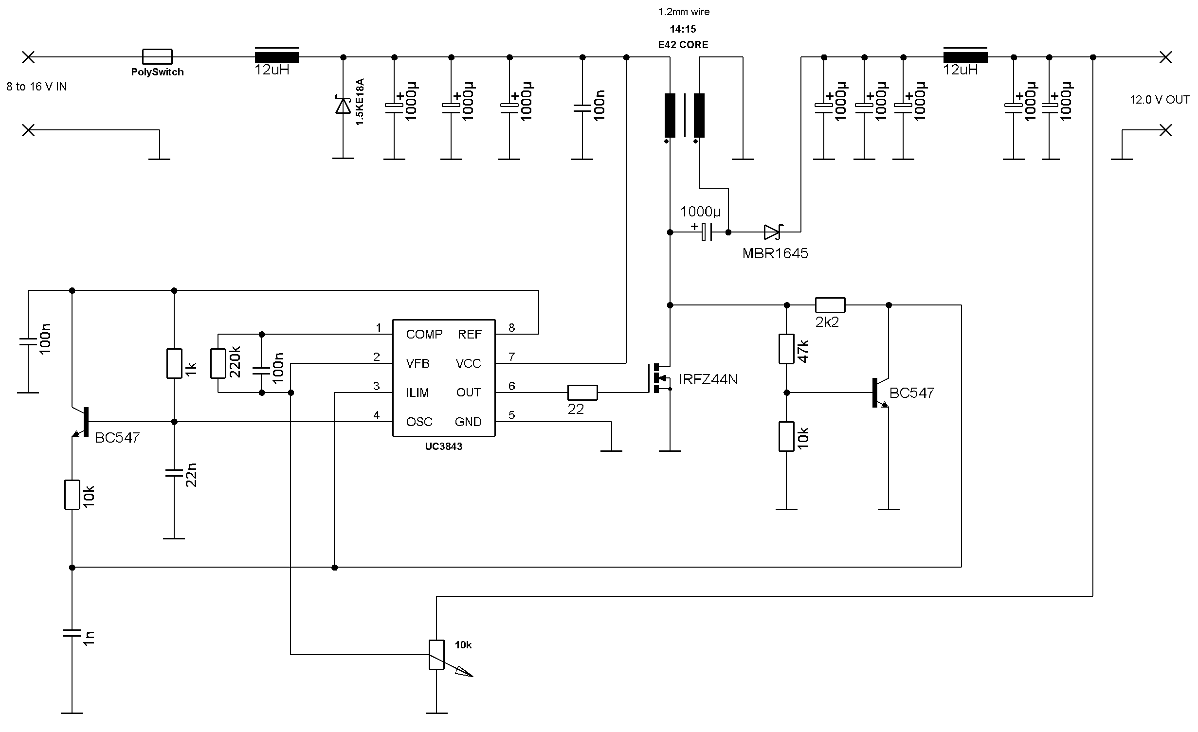

Hi Alain,
thanks for the link, but at the first glance I can't see any benefit.
With my latest design I get really good results even at high loads.
I really don't want to spend yet another number of days finding inductors and capacitors to push a different Controller to the efficiency I have already reached with my current design.
You and I know:
it takes a little more than just adding a MOSFET...
and other simple things a datasheet tells you.
Let others pick up this topic and let's see what they come up with...
