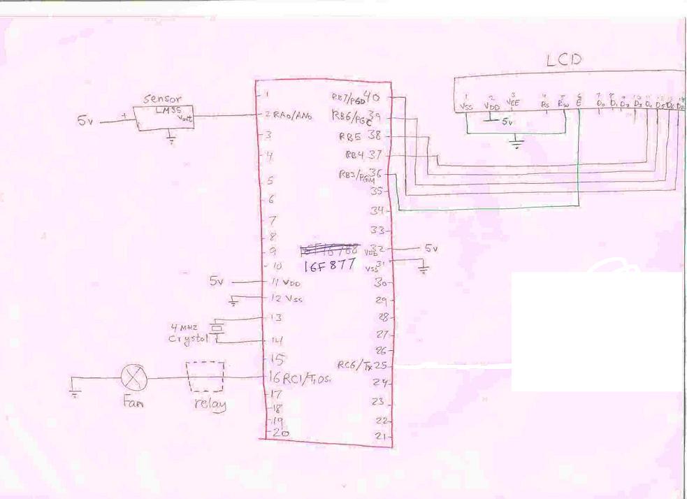

    hello to all
    could any one help me . i have this circuit
    and i want to do the PIC read the signal form the sensor and do compare like if the signal is 20 turn ON the Fan , and if the signal up 20 turn OFF the Fan and all this i want to shown in LCD. i have a code but does't work i know know why? if any one know what's wrong plz tell me. thank you very much
    all the best
    and i have a code or the program does't work i do't know.
    thank you very much

    Default Doesn't seem like a PBP code
    Although I do not use PROTON it seems that this is a "PROTON" code and will not compile in PBP.
    May be something of this sort may work.

    It compiles okay and "hex attached"

    hello,Dear Sir;
    sougata
    thank you very much.
    could u explan to me more what are u worte.
    i want PIC to take signal from the Sensor and do compare and turn ON if the temperatue LOW and turn OFF when the temperature HIGH.and show the temperature in LCD.
    and your answer for only anlogue to digital . could u tell me all. and u said i do't no PROTON no problem. do u know how to write the all code without PROTON. i mean same what to write to me.
    iam so sorry bec my language is not perfect.
    i hope to understand what i mean.
    many thanks

    Default Did the code work for you ?
    Hi there,
    Are you new to programming or just trying to use a micro for the first time ? Let me know the compiler version you are using and I shall try to explain.However it is important if the code at all worked for you. That is if you at all got any display.
    Sougata

    hello Dear Sir;
    sougata
    yes this time first time to use PIC program. and i have project call Automatic control and display of Room temperature. and i thing to use PIC and i have my friend tell me use PIC Basic language it's easy. and he give me the code same i put in the first topic.and u give me a code similler my code. and what do u mean which compiler version u mean the program. i have PROTON IDE Lite.
    if also in the university MPLAB program.
    Excuse me Sir could i speck to u by Email. and my Email ; [email protected]
    thank you very much
    all the best

    Default This is not the right forum for you
    This forum is for PIC Basic Pro. This forum is located at www.picbasic.org/forum/ .Since I am not a Proton user it is not possible (practical) to comment on code examples. Regarding email, it is not necessary because this forum is full of pros. This forum has helped me a lot to understand the complexities of programming. I hope you would find somebody on the Proton forum to help you out.
    Best of Luck
    Sougata

    Default I converted the code into PBP
    The code example that you posted was in Proton PIC Basic and I converted it into PBP ( PicBasicPro).
    In this forum we share codes and problems but you have to walk your own way. You may find somebody to give you code examples to sort out problems but you should have the understanding of what you are doing. Otherwise it would be impossible for you to upgrade/maintain/troubleshoot your program. As I have been a hobbyyist I always have the intention to help hobbyist but with a micro you cannot simply expect to do a copy/paste sort of experiment.
    Send me what you want to do exactly, what features you want and what PIC you want to use. I will try to post some examples if possible.
