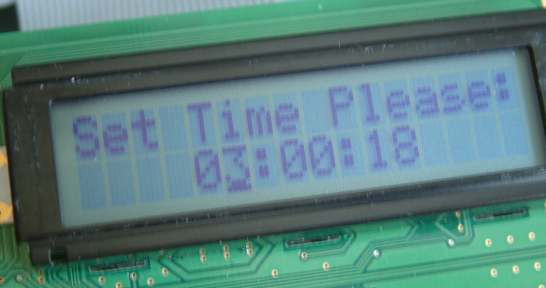

    Default A real live working example of ONE Button usage...
    This appended example is the basis for the worlds most inaccurate clock.
    It’s demonstrating ONE Button usage.
    Press the Button momentarily and it will flip the display between 12/24 Hour Mode.
    Press the Button for an extended time and it will jump into a Menu for you to set the time. Note the creative use of the CURSOR to indicate when a SET Function has been executed...
    It’s just a ditty to show how you can do things with ONE Button.
    And shows that code previously written (Olympic Timer) for a PIC16F876 can be quickly and easily ported and modified for a PIC16F628, or PIC16F628A or B or C...
    It’s also a teaser for half a dozen recent (Timer) threads (and for a gentleman searching for an elapsed timer – hint – hint – somebody nudge him to look at this thread!!!!) to show what can be done with 10 minutes worth of code, half a bucket of Cafe Nero's finest and a plastic straw...

    Melanie I've added your code into my project. When setting the times hours, minutes, or seconds the display clears and only displays the value that is currently being altered. Are you seeing the same thing or am I missing something?
    2,358
    You're doing something wrong...
    When setting the Time, you can see all the fields (by field, you can see Hours, Minutes and Seconds on the same line, and as you press momentarilly, only the field you are currently parked on will change. When you hold for SET, the cursor changes from an underscore to a Block and on finger release moves to the next field, leaving the previous one with the content you set.
    I refer you to the Button-02 picture... there you can see the underscore cursor parked in the Hours field... pressing momentarily will advance Hours through to 23 then cycle around starting from zero. Hold the Button for SET and the cursor changes to a BLOCK, and on finger release moves to Minutes changing back to an Underscore.
    Check your $FE,xx's are the same as mine...
    Melanie
