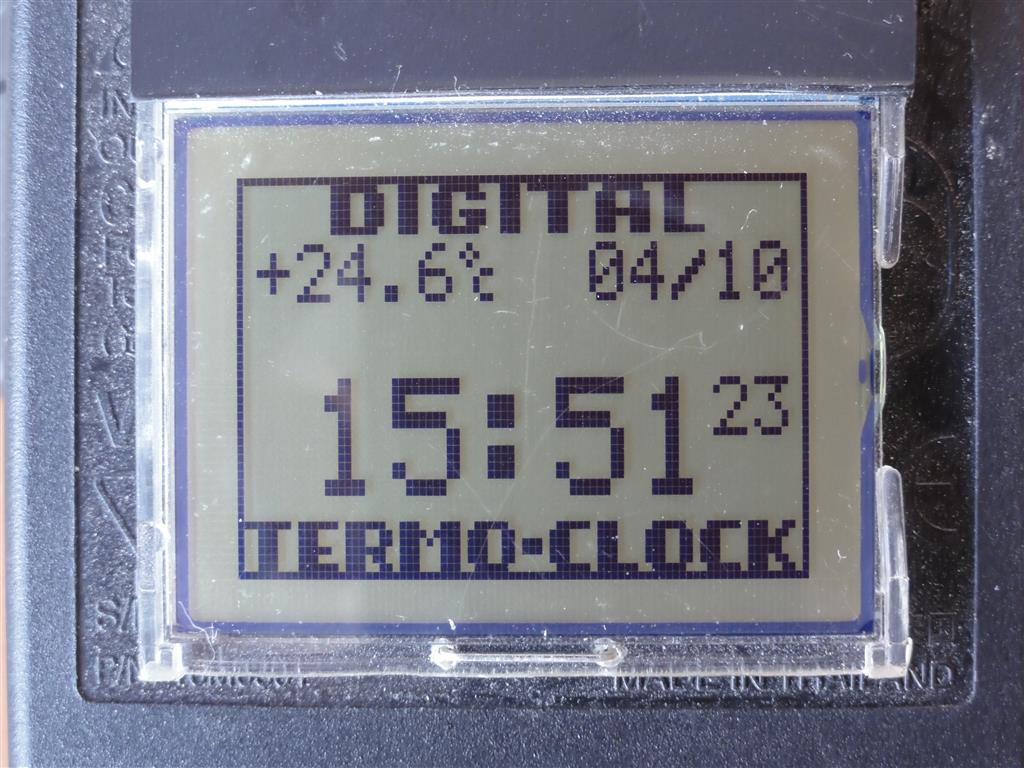

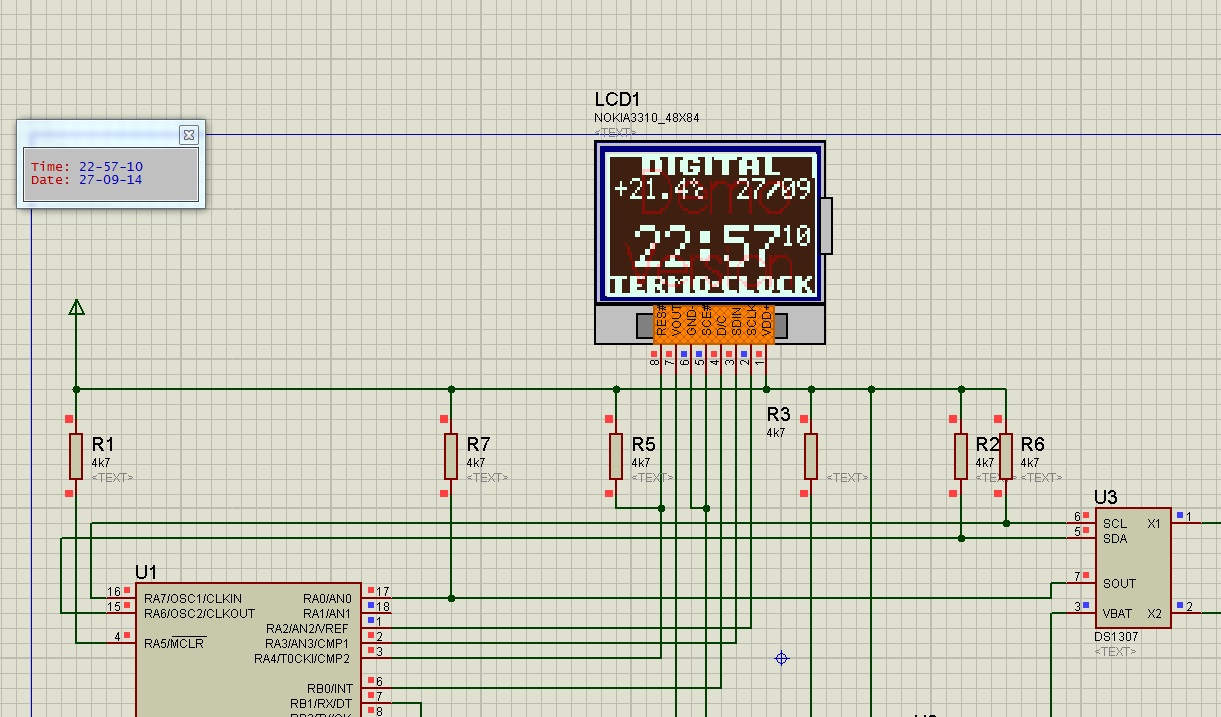

    Old thread ... but nice !
    This is my last soft & hard for interfacing with Nokia display : termo-clock.
    Enjoy !

  5. #285
    Sep 2009
    755
    Default Re: Using Nokia LCD
    Nice.
    Can you post proteus and pbp files?
  6. #286
    Dec 2008
    Ploiesti, ROMANIA
    582
    Sure .... Enjoy !

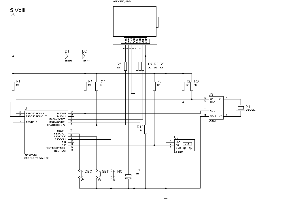

  7. #287
    Sep 2014
    1
    • could you attach circuit diagram for your final version termo clock .
      Thanks in advance !!!
  8. #288
    Dec 2008
    Ploiesti, ROMANIA
    582
    Yes, this is it !
  9. #289
    Sep 2009
    755
    Thank you very much.
    I need to find way to import lcd model in proteus.
  10. #290
    Dec 2008
    Ploiesti, ROMANIA
    582

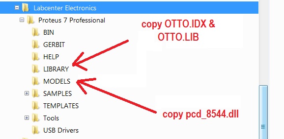

    Copy each file into corresponding Proteus folder.
  11. #291
    Sep 2009
    755
    Thanks.
    I will try it, when get back...

    Did you do it like in picture ?
    [ATTACH=CONFIG]7463[/ATTACH

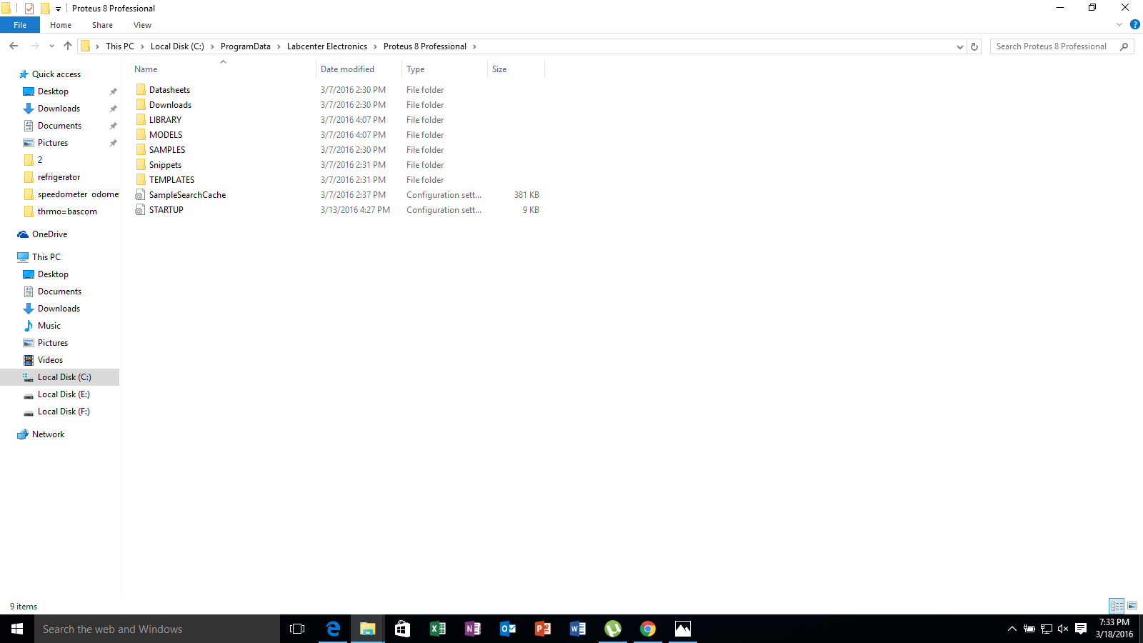

    I have proteus 8 installed on pc, and there is no existing LIBRARY folder. Anyway I put files as it is on picture, but didn't work.
    I'll try to install proteus 7, and give it try.

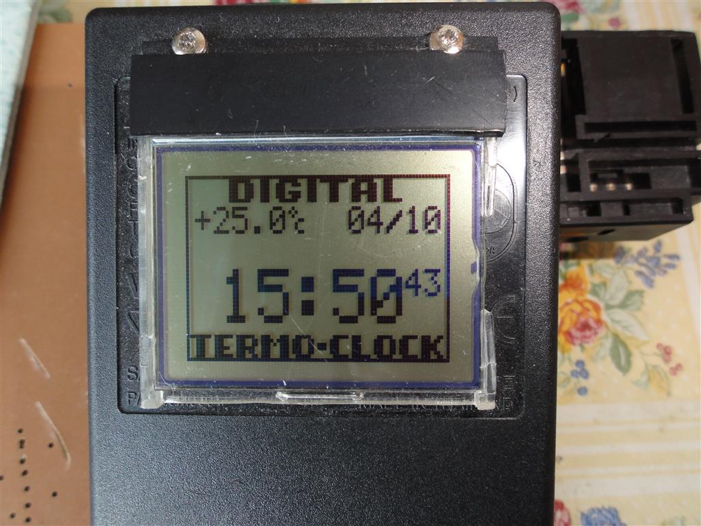

    Update soft ... bug with "seconds" position resolved. See attach.

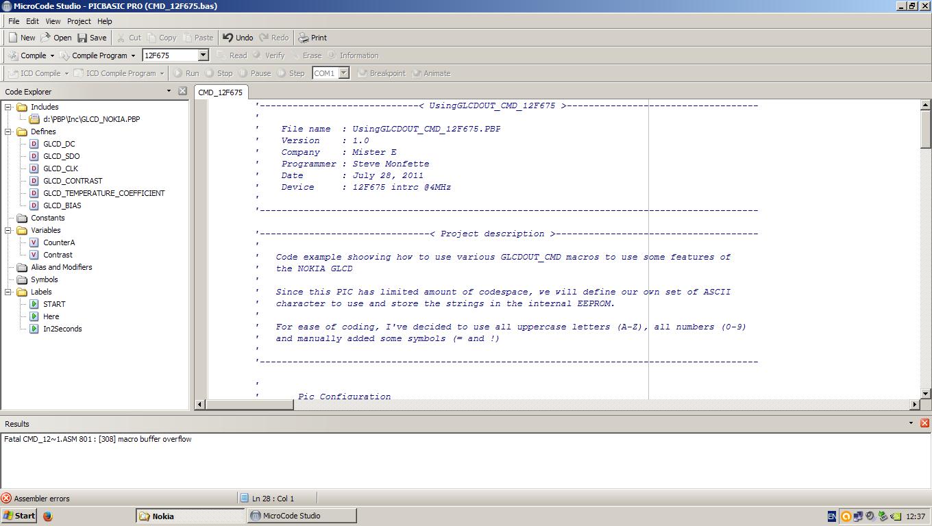

    What is wrong here ?! Macro buffer overflow ...
    Thanks !

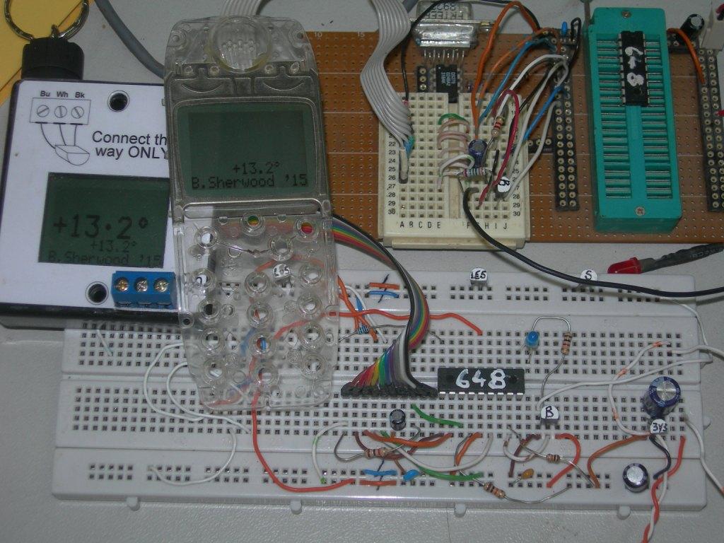

    Sorry to hijack the thread but I thought this was the best place to put it...
    Attached my code example to write big characters to the Nokia 3310 LCD using custom fonts to smooth the normally large chunky characters (made with FastLCD). I have a weird fault where the breadboard setup works fine however exact hardware and code on a pcb works in every aspect apart from displaying the Big characters! Both run from the internal oscillator at 4Mhz and if serial is included there is no corruption observed on either.
    As shown in the photo the left display (pcb cover) works fine connected to the big breadboard while the plain LCD connecting to the veroboard/ZIF socket/small breadboard runs except no Big characters. Swapping PIC's (identical code) or LCD's between the two makes no difference. The board is setup with a DS18B20 for temperature measurements but the code has fixed values for display testing.
    Does anyone have an idea on why this doesn't run off the breadboard? One would expect it to be the other way round due all the additional inter-capacitance of the protoboard but not so in this case... My o'scope is an old one with limited bandwidth so I can't really see much difference between both sets of waveforms and suspect timing is an issue however including delays in Shiftout makes no difference.
    While on the subject I want to use a bigger PIC for greater code space and settled on a 16F1847 but there are errors and it won't compile when using the "GLCD_NOKIA.bas" include file from Mr.E - who can't be thanked enough for his hard work in developing this Include. My asm skills are zilch so any help appreciated. The config allows for testing the same code with this device.
    I hope my example is of use to others, these are very basic LCD's but cheap and plentiful so I think will be with us for a while, ironing out some bugs is worth the effort and I am sure will apply to other displays as well.
    Kind regards,
    Bill
    check this for proteus 8

    The Nokia Big Character mystery is solved finally after getting back to the problem with some spare time...
    My post with the photo and code showed two identical setups and only one with Big Characters working while the other - working perfectly displaying normal size characters - did not show the Big ones. In fact the two breadboards (and the pcb I made) were not identical: the working unit had the Nokia LCD's /CS line tied to ground while the other (no Big Chars) was being driven by PortB. Making the non-working breadboard (and the pcb) the same fixed the problem.
    Why did this affect only Big Characters display? I have no idea except to offer the BC generation uses Shiftout and not Mr.E's wrapper and suspect there is a very narrow timing window if using /CS for the routine. Not owning a Logic Analyzer didn't help.
    The only remaining problem is the one whereby Steve's wrapper appears incompatible with the 16F1847 (and probably a good number of the enhanced chips) so if anyone with the skills can correct this I'd very much appreciate learning from the exercise.
