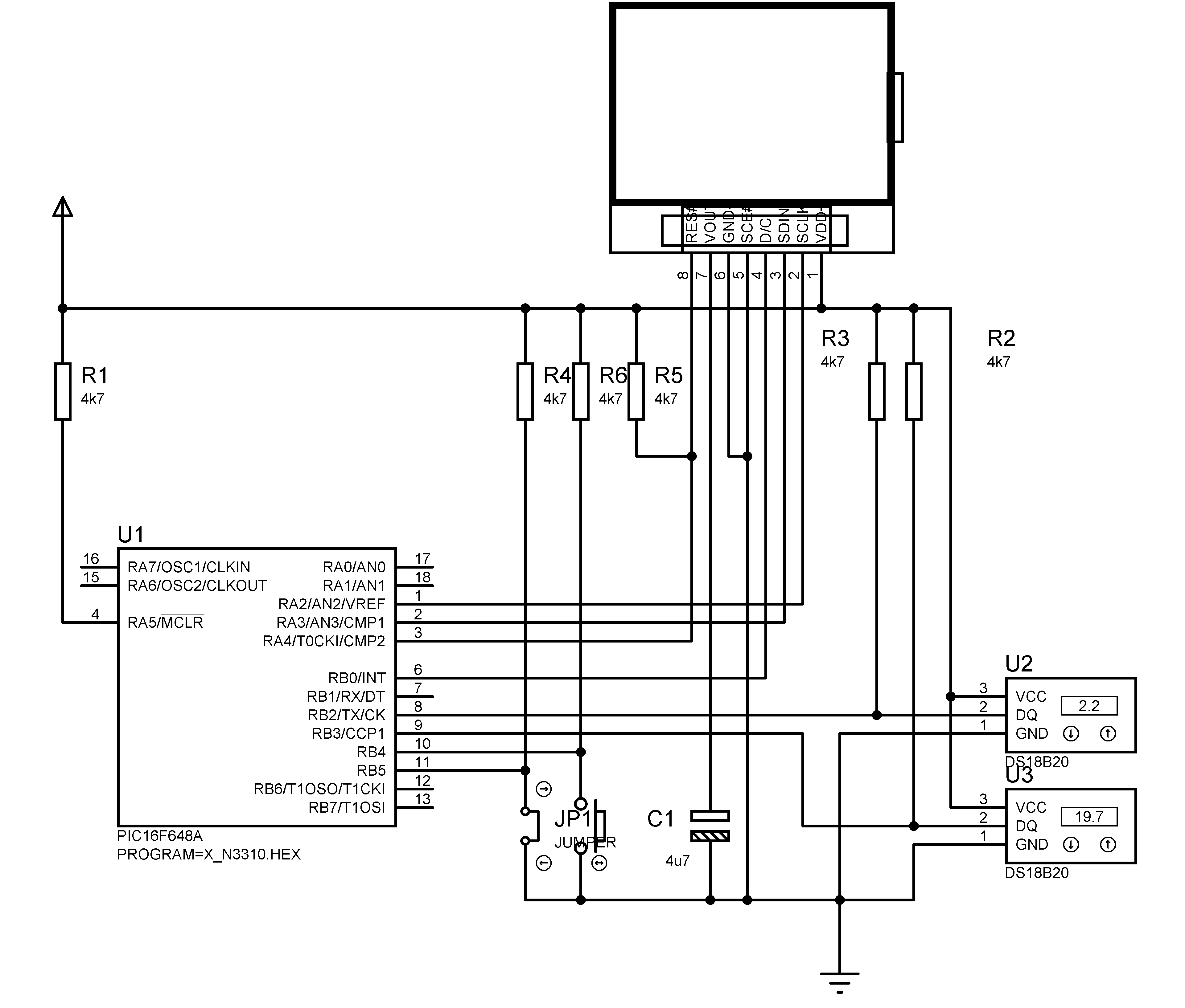

    I ALWAYS use this LCD with SCE to ground . Try to find Nokia 5110 display ; it's more easy to "interfacing".
    LE : I don't use LCD_VCC from PIC's. Just be careful to power with maxim 3.3 volts !!! Now I use this (second) schematic, with good results !

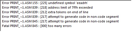

    i get the following error

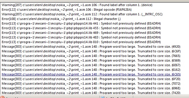

    when i compile with MPASM
    i get EEADRH erros how can i correct it? please help. I think i will never manage to use my nokia lcd

  16. #216
    Default Re: Using Nokia LCD
    Seems you're out of codespace... choose another PIC (like PIC16F877) and see if this compile.

  18. #218
    Dec 2007
    Finland
    191
    Your PIC cannot use READCODE command.
    READCODE: Some PIC16Fxxx and PIC18Xxxxx devices allow program code to be read at run-time. This may be useful for additional data storage or to verify the validity of the program code.
    .MAC -file contains:
    READCODE?TB macro Regin, Bitin, Bout
            MOVE?TB Regin, Bitin, EEADR
        clrf    EEADRH
            L?CALL  READCODE
            MOVE?AB Bout
    READCODE_USED = 1
    And if you check from PIC16F627A/628A/648A datasheet, there is no EEADRH register in the these PICs (reason for error). Therefore you cannot use Scalerobotics (Walter's) great addon (=@ PrintStr) as it is now.
    Also other note about READCODE
    For PIC16F devices, 14-bit-sized data can be read from word code space Addresses.
    Addr  VAR WORD
    Variable cannot be WORD.
    Easiest is to change to some other PIC, which support READCODE (e.g 16F8/74A/76A etc...) and which have also more code space
    BR,
    -Gusse-

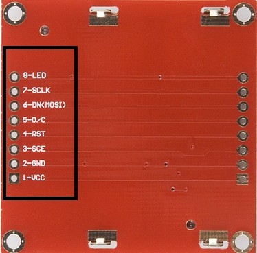

    How to connect display...
