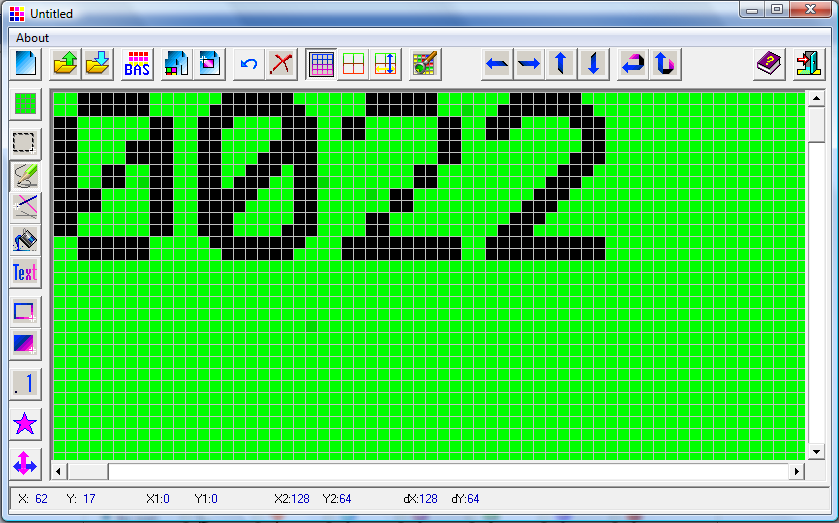

    Default font and bitmap tool
    The attached program fastLCD.zip will help you with text, as well as graphics. It will let you create characters, and it will create hex for them.
  4. #164

    Nice program, but I use already Excel (bin2hex) for those big characters...Unfortunately, I need to understand the codes You and HJota propose and modify all my code; the procedures for define and display the characters are different...Per aspera ad astra ...

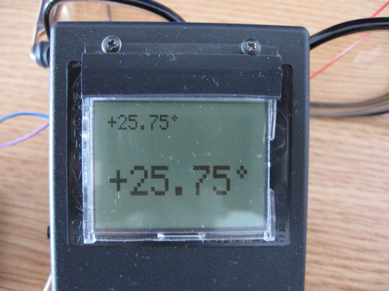

    I succeded to display "23.56" ! it's a step, don't ?!
    Now, assuming that I succed to write the code for reading DS18B20, how display temperature instead "23.56" ?
    It's correct so : " lookup i, [temperature DIG 3, temperature DIG 2, temperature DIG 1], j" or how ? Thanks !

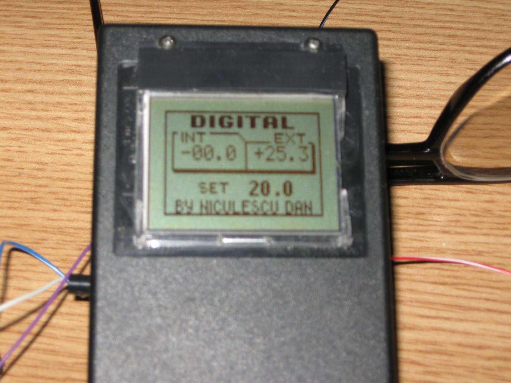

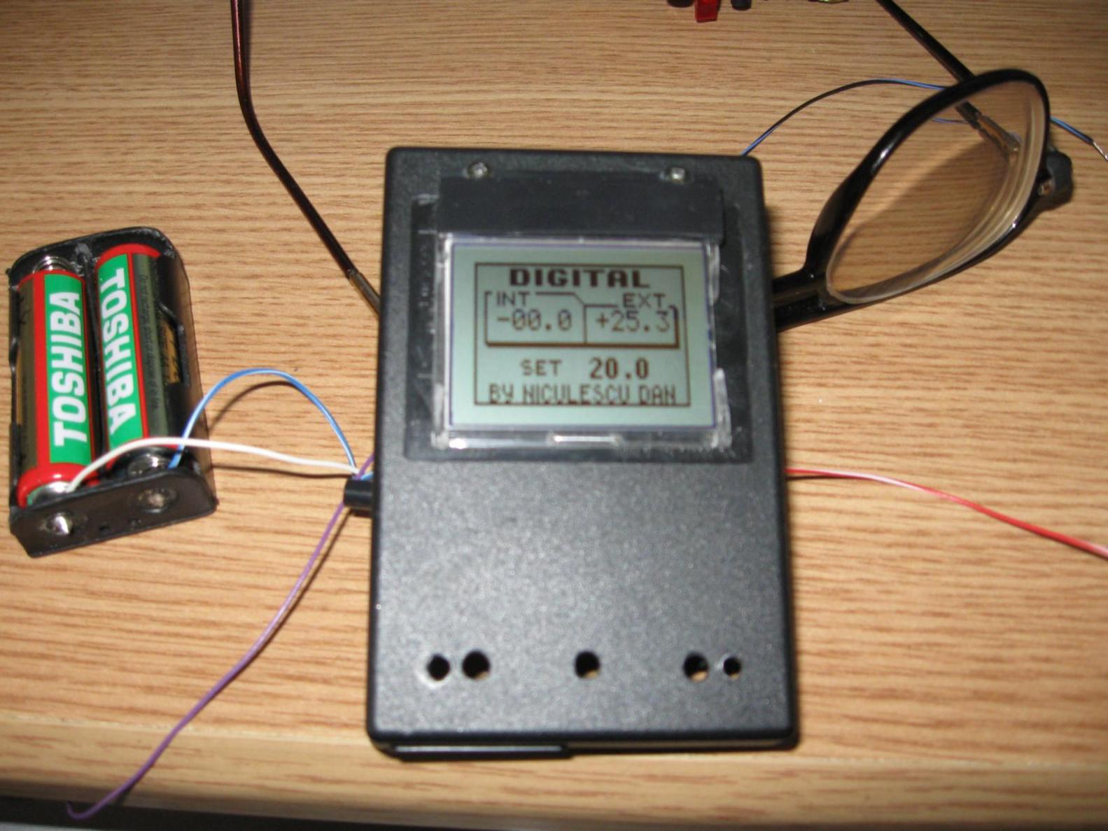

    Default And the results are...
    like in picture attached. The code works great, with one DS18B20; next project is, of course , termo with two zone, with thermostat, with clock, etc.,....
    THANK YOU ALL !

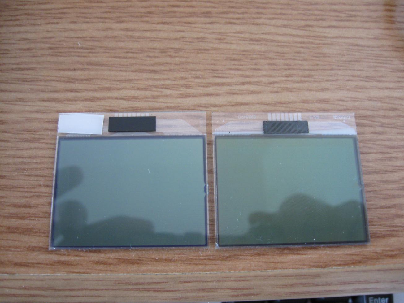

    Default Strange problem with not original display
    Because this topic it's still "hot" I wonder if somebody have meeting this problem : I bought some Nokia 3310 displays and bottom of display appears these stranges characters...using same code and hardware (see post #169). The results on display are like in picture (original vs fake; both display look hardware just the same). Suggestions ?! Thanks !
  15. #175
    Not sure if this will help, but I did notice a difference in the way we initialize the display.
    Try adding some time, and another pause after, and see if that helps.
      Low Lcd_RST
      pause 50
      High Lcd_RST
      pause 50
    Otherwise, my only advice would be to try to get from same manufacturer. One display seems to have the part number info on it, the other does not. Is the one with the part info printed on it the working one?
  16. #176
    Dec 2008
    Ploiesti, ROMANIA
    582
    Default Last line don't erase !
    Even with "pause 100" don't work ; still "fleas". And yes, the display with part info printed work good. The last line it's with problem !!!! She don't want to be erased !! I try another program and look at differences. First two foto are with good display; "main" program - and, after LCD_clear , "set" display. The last two are with "fake" display. The last line remain from "main" program display !!!

    So, somebody is selling fake 3310 LCD displays, that are actually with 102*80 controllers. Nice practical joke!
    I bet that those aren't made by Philips, Samsung or Seiko Epson.

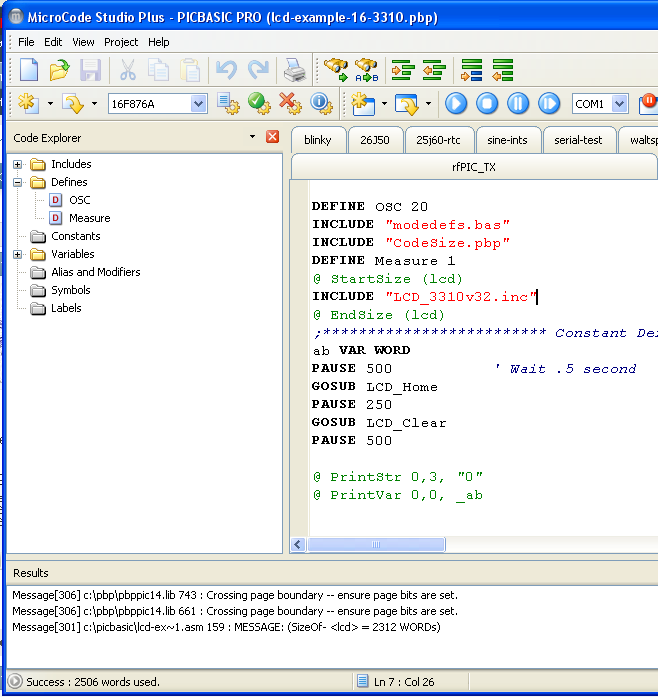

    With a 16F648A:
    Error[113] e:\wjs\pbp260\pbppic14.lib 449 : Symbol not previously defined [EEADRH]
    Message[303] e:\wjs\pbp\NOD157~1.ASM 185 : Program word too large. Truncated to core size. (4920)
    too many errors
    With a 16F876A there are 20 lines of:
    Message[303] e:\wjs\pbp\NOD157~1.ASM 187 : Program word too large. Truncated to core size. (4920)
    Does this give you any ideas where my problem with 16F's is? What are the chip requirements for using this macro - codespace, ram size, etc,?
    Thanks and regards,
    Bill

    I think this might be a version issue for Mpasm, or PBP, but really not sure. I get a nicely compiled result at 2312 words for your version of include file.
    I can fit 96 more bytes in RAM, so there is a bit more left, but as you can see, my program is small.
