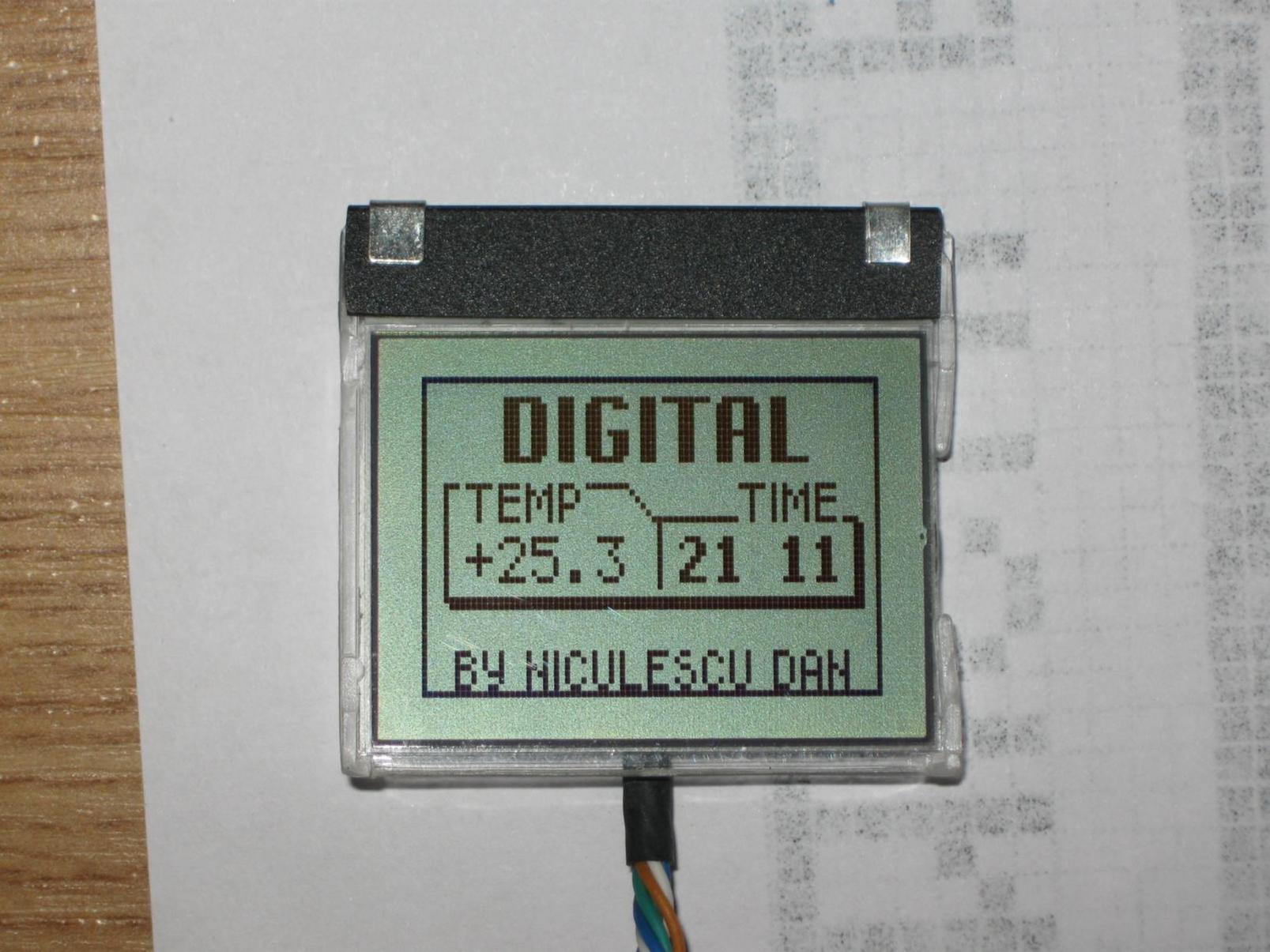

    The display show like in picture from post #116. But pushing the buttons '+' , '-' or 'Mode' has no effect.

    I can't - insuficient memory ! - using design like in post #116 (borders & author name). How to free memory ? I think the code can be optimized...
    Easiest way . . . Use 16f648A, then you have room to stretch your legs.

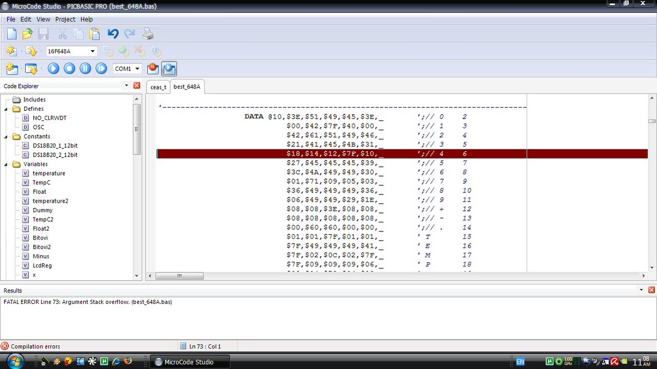

    Hi Fratello,
    I tried to compile the file you put here. It did not give any error to me like what you said. The resultant files are appended in the zip file for ready reference.
    Sarma

    The code is full functionaly ! The graphics it's disable... If try to improve the way that "look" the display, it is no more space in memory...I think the solution it's to 'up-grade' to another PIC, with bigger memory !

    Me again...with one new problem : I write the code attached, for 16F648A, because I want to display some graphics elements (see sus, rand 1, rand 2, rand 3, rand 4, jos) .But when I put the code in Microcode Studio I receive the message "Warn : Test_648.asm 790:[102] code crosses boundary @ 800h". I think the code it's too big; please give me some solution !!! I want that my display having one nice 'looking' and without the parts for graphics elements...What can I do ?
    Thanks in advance !

    That is just a warning that you are crossing a boundary. All is good. How many bytes does it say you are using the lower left of microcode studio?

    This is what MicroCode Studio say :

    Your code compiles OK (2932 words used). I don't understand what can be wrong with your setup? If you close and restart the MicroCode Studio, would that help? At least sometime that has helped me.
    To get rid of "code crosses boundary" goto tool bar:
    View -> Editor Options...
    In General sheet, select "Disable 'code crosses boundary' ASM warning.
    BR,
    -Gusse-

    The first one is about your config fuse. intrc_osc should be replaced by
    INTRC_OSC_NOCLKOUT
    This one use the same config fuses as 16F628A & 16F627A. The complete list is in M16F62XA.inc file in pbp\inc folder.
    The second one is just a warning,
    http://picbasic.co.uk/forum/showthread.php?t=555&
    Can be bypass within MicroCode Studio.
    http://www.picbasic.co.uk/forum/show...66&postcount=2

    Code is OK. May be you need a restart.
    Steve, the define is OK. It exists this too!

    This is final version. I try to implement the function of clock (like this : http://www.picbasic.co.uk/forum/show...ght=clock+code ) but, even the code works verry, verry fine alone, I can't put together with my thermo....If somebody can do this...All the best !
