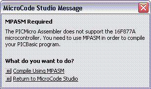

    You have to be using MPASM as the assembler.
    The default PM assembler will not work.
    <br>
    Sep 2007
    USA, CA
    271
    Darrel,
    How about a little tutorial on how to tell which assembler is in use, and how to switch to the mpasm?
    OK, how bout this for detection ...
      ifdef PM_USED
           "Dude, you have to use MPASM with DT_INTS"
    If you put that in your program, and try to assemble it with PM.exe, It will automatically pop-up a window in MicroCode Studio like this ...
    <img src="http://www.picbasic.co.uk/forum/attachment.php?attachmentid=2450&stc=1&d=120694493 9" />
    Then you can just click on "Compile Using MPASM", and it will set the MPASM option and compile it.
    If it still fails to compile, you should try this ...
    http://www.picbasic.co.uk/forum/show...5&postcount=11
    I should add that to DT_INTS-14.
    hth,

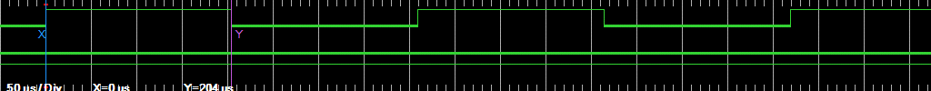

    This code is lifted straight from Darells example with the blinky led (1-2-3 version), and all I have done is add the pre-load. I have also removed the pre-load and still get the same time for the interrupt.
    DEFINE OSC 20
    rs_led      var portb.7 ' rs232 led
    led         var portc.4 ' was Data_Out line
    INCLUDE "DT_INTS-14.bas"     ' Base Interrupt System
           INT_Handler   TMR0_INT,  _doBAM,   PBP,  yes
        INT_CREATE     ; Creates the interrupt processor
    OPTION_REG = OPTION_REG & $80 | 1     'Set TMR0 Prescaler to 256, leave RBPU alone
    TMR0 =  158 ' preload with 158 to give 21uS interrupts (at 1:1)
    ' this should then give Interrupt every 5.019mS at 1:256
    @ INT_ENABLE  TMR0_INT     ; enable Timer 1 interrupts
    goto main      ' jump over ISR
    '---[TMR0 - interrupt handler]--------------------------------------------------
    doBAM:
    toggle rs_led
    @ INT_RETURN
     high rs_led
    ' do some flashing led stuff
    high led
    low led
    There has got to be something really simple I am missing...
    bill.

    hello,
    i just tested the program with the 16f88 but it s not working , there are some error messages.
    dont know exactly what to do next
    can u give me some advices please??
    thanx
    NO.. at least give more details... error message, code etc etc
    Make sure you're using MPASM to compile
    skimask's Avatar
    skimask Guest
