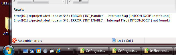

    I downloaded the latest version 1.10 for the DT-INTS14 and now I get a lot of errors.
    Does anyone else has the same problem? With v1.0 had no error (but nothing was working either.... )
    I want to use IOC of a F887 device.
    The test code is this:

    The errors are like ERROR: (" Add:" wsave1 VAR BYTE $A0 SYSTEM, Or change to wsave BYTE $70 SYSTEM)
    or
    ERROR: (Chip has RAM in BANK3, but wsave3 was not found.) etc

    Sorry I did not fully understood what you mean...
    With the old (version 1.00) there is no problem in compiling with RBC_INT interrupt. With 1.10 I get various errors like the ones posted.
    Of course I made a mistake in interrupt selection. IOC_INT should be used and not RBC_INT.
    With the old version 1.00, after compiling I get
    ERROR: ("INT_Handler" - Interrupt Flag (INTCON,IOCIF ) not found.)
    and
    ERROR: ("INT_ENABLE" - Interrupt Flag (INTCON,IOCIF ) not found.)
  12. #612

    OK, Darrel pointed what to do. I did uncomment the wsave1,2,3 lines and put on the main program the lines:
    wsave   VAR BYTE    $20     SYSTEM      ' location for W if in bank0
    ;wsave   VAR BYTE    $70     SYSTEM      ' alternate save location for W
    It seems that it doesn't matter which one I un-comment as it compiles both.
    But with version 1.10 of the DT-INTs I have a new error about the INTCON,IOCIF flag...

  17. #617
    4,175
    When compiling the attached file I get the attached error.
    It drives me crazy....

    Are you still compiling for a 16f887? Because that chip doesn't even have a IOCIF. I think only the 16f1827's and such have one of those. So that is pretty weird.
    http://www.scalerobotics.com
  20. #620
    For a 16F887, it's RBC_INT.
    You can tell that from the datasheet which specifies "PORTB change" interrupts.

  21. #621
    Your code compiles here without errors. PBP 2.60A
    To be clearer, your code in post 609 compiles using the code shown. I had not tried it with the IOC_INT, only with the code listed in post 609. I guess you meant that when you changed it to IOC, you got the errors.....
    Sorry
    Walter

    4,175
    Thanks all for the support.
    Al.: We are testing the new DT-INTs version 1.10. Here as Darrel pointed out the wsave are set in the main program.
    Darrel: You are correct in the Port change Interrupts. Ok, I have them corrected and the two errors went away. But no joy on Interrupts. It seems that they are never triggered.
    The latest test code is this:

  23. #623
    Ioannis,
    Remove the second CLEAR statement, and move the GOTO Main after the interrupt declaration, just before the IOC2: handler.
    The interrupt declaration and the IOCB/WPUB must be allowed to execute.
  24. #624
    4,175
    Hi Darrel.
    Well, with 3 toddlers running around till 10.30 pm sure I will have double CLEAR commands to clear my mind!
    OK I moved the IOCB/WPUB before GOTO main but still no Interrupts occur.
    In fact is second or third try with different controller that I cannot make an interrupt on change to work... Not lucky I guess.
    t1con=%00000000         '65,535ms interrupt time base
    IOCB=%00010000          'Enable IOC on PortB.4
    WPUB=%00010000          'Enable weak pull up on PortB.4
    '-------------   INTERRUPTS SETUP   ---------------------
    INT_LIST  macro;    IntSource,  Label,      Type,  ResetFlag?
        INT_Handler     RBC_INT,    _IOC2,      PBP,    yes
    @   INT_ENABLE  RBC_INT      ; Enable Port B on change
    IOC2:
        high portb.1
        if portb.4 then
            high portb.0
            low portb.0
    @ INT_RETURN
    while 1
        toggle portb.2
    wend
    Thanks for the efforts.
  25. #625
    4,175
    OK. I got it. Was the goto main before Interrupt setup.
    Sorry for my careless... A cupof coffee did the job!
