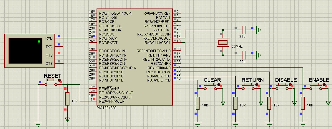

    Default Understanding RBC_INT... or not
    I've been trying vary to fully understand the RBC_INT interrupt handler in DT_INTS-18.pbp.
    So I wrote this little program, Created a simulator circuit model and also a similar hardware circuit.
    Here is the Code:
    ' RBC TEST.BAS
    ' PIC 18F6480
    ' MPLAB IDE V8.40
    ' PBP V2.60
    ' Build Options: [-ampasmwin]
    ' RB4  Momentary Contact Button Goes High on Press,  10K Resistor to Ground
    ' RB5  Momentary Contact Button Goes High on Press,  10K Resistor to Ground
    ' RB6  Momentary Contact Button Goes High on Press,  10K Resistor to Ground
    ' RB7  Momentary Contact Button Goes High on Press,  10K Resistor to Ground
    ' RC6  22K ohm to RX on 57600-N-8-1 Serial Terminal
    INCLUDE "DT_INTS-18.bas"		; Include Darrel Taylor's Base Interrupt System for PIC18F [Version:3.4 (NOV 04, 2009)]
    DEFINE OSC 20
    DEFINE DEBUG_REG PORTC
    DEFINE DEBUG_BIT 6
    DEFINE DEBUG_BAUD 57600
    DEFINE DEBUG_MODE 1
    DEFINE  SHOWDIGITAL 1
    TRISB=%11111111
    ADCON0=%00000000
    ADCON1=%00001111
    BTN	  VAR	BYTE
    INT_LIST  macro ; IntSource,  Label,      Type,  ResetFlag?
            INT_Handler RBC_INT, _DO_RBC_INT,   ASM,  yes
        INT_CREATE
    @  INT_ENABLE   RBC_INT
    DEBUG "INTERRUPT CREATED",10,13
    DEBUG "INTERRUPT ENABLED",10,13
    HOLD_HERE:
    DEBUG "WAITING FOR INTERRUPT",10,13
    PAUSE 2500
    GOTO HOLD_HERE
    DO_RBC_INT
    DEBUG "############### RBC INTERRUPT ACTIVATED #################",10,13
    MENU:
    PAUSE 200
    DEBUG "MENU - READ BUTTONS",10,13
    If PORTB.4 = 1 Then PAUSE 250: Goto DO_ENABLE
    If PORTB.5 = 1 Then PAUSE 250: Goto DO_DISABLE
    If PORTB.6 = 1 Then PAUSE 250: Goto DO_RETURN
    If PORTB.7 = 1 Then PAUSE 250: Goto DO_CLEAR
    GOTO MENU
    DO_ENABLE:
    DEBUG "RUNNING DO_ENABLE",10,13
    Pause 250
    GOTO HOLD_HERE
    DO_DISABLE:
    DEBUG "RUNNING DO_DISABLE",10,13
    @ INT_DISABLE RBC_INT
    PAUSE 250
    GOTO HOLD_HERE
    DO_RETURN:
    DEBUG "RUNNING DO_RETURN",10,13
    @ INT_RETURN
    PAUSE 250
    GOTO HOLD_HERE
    DO_CLEAR:
    DEBUG "RUNNING DO_CLEAR",10,13
    @ INT_CLEAR RBC_INT
    PAUSE 250
    GOTO HOLD_HERE
    Here is the Circuit:
    There are 4 buttons connected to PORT B <4.7>
    Here are my observations:
    The first press of any button activates the RBC Interrupt and sends program to DO_RBC_INT subroutine, then on to MENU where it checks for button presses. This behaves exactly as I would expect it to.
    Now...After that....
    Pressing Button RB.4 [ENABLE] Runs the DO_ENABLE subroutine then the HOLD_HERE subroutine. At this point, the Interrupt handler seems to shut down as no Port B inputs activate the interrupt handler. I would expect the Interrupt to remain active.
    Pressing Button RB.5 [DISABLE] Runs the DO_DISABLE subroutine then the HOLD_HERE subroutine. The Interrupt handler is now disabled as expected.
    Pressing Button RB.6 [RETURN] Runs the DO_RETURN subroutine then the HOLD_HERE subroutine. It then sends program to DO_RBC_INT subroutine, then on to MENU. I would expect it to return to HOLD_HERE which is wherr the interrupt was originally activated
    Pressing Button RB.7 [CLEAR] Runs the DO_CLEAR subroutine. At this point, the Interrupt handler seems to shut down as no Port B inputs activate the interrupt handler. I would expect this to just clear the interrupt then await another RBC trigger.
    So it seems I can only activate the interrupt one time.
    It doesn't seem to matter whether I use ASM or PBP types or set Resetflag to yes, or no
    Can anyone shed light on what I'm doing wrong, or am I simply misinterpreting the function of the INT_* utilities.
    I'm just not sure if I've got a mistake, am staying up too late working on this stuff, or just really don't get it.

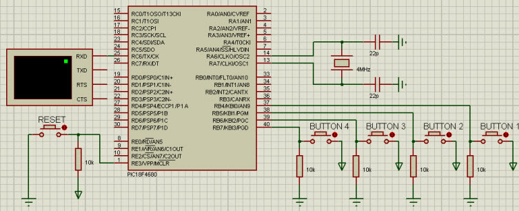

    Well I think I've finally figured out some of the nuances of RBC_INT.
    I think the last example I tried to use was not a very good way to test it out.
    I tried to document this working code example in a way that's understandable and can be used as a template to build on.
    This is setup with PBP type interrupts using ReEnterPBP-18.bas, since I'm using PBP in the Interrupt handler, but ... it seems to work just fine when run as ASM type, and not including ReEnterPBP-18.bas. You can just uncomment out the appropriate lines to suit your needs.
    The thing that was giving me so much of a headache before was the need to read one of the Port B <4-7> registers prior to exiting the Interrupt handler. This ends the mismatch condition and allows the RB Port Change Interrupt Flag Bit to be cleared. Even though I was reading the Port B <4-7> registers frequently, it seems that using GOTO to enter the Interrupt handler exit subroutine, caused the Interrupt Flag Bit to reset.
    Program operation:
    This Program uses DEBUG to send status comments to a 9600 Buad Serial ASCII Terminal on PORTC.6
    On first press of any of the PORTB<4-7> buttons, the program enters the interrupt handler.
    The Interrupt Handler, continuously reads the buttons.
    Buttons 1,2 & 3 just display a status message. You could put any subroutine in place of the DEBUG Statement.
    Button 4 gracefully exits the interrupt handler.
    At this point, RBC_INT is reset and awaiting any PORTB<4-7> button press again to reenter the Interrupt handler.
    Anyway here's the Code and a schematic of the setup... I hope this helps someone who's struggling with RBC_INT like I was.
    The ZIP file attachment has the code, and copies of the version of DT_INTS-18.bas and ReEnterPBP-18.bas that are included.
    Bob W.
